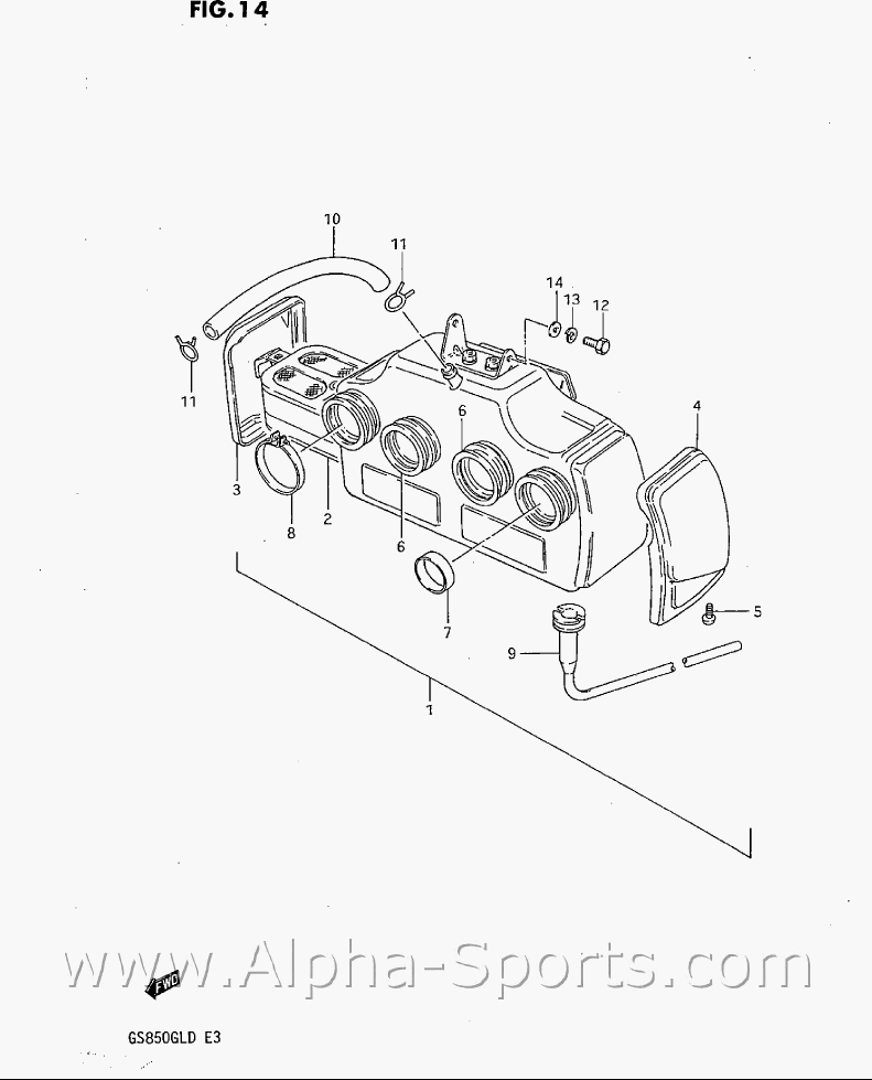

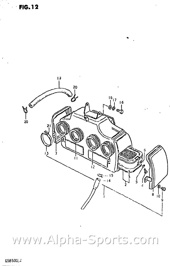

it's #2 in this picture. http://www.alpha-sports.com/spst/1982 GS850GL/01.gif
or #2 in this one. http://www.alpha-sports.com/spst/1980 GS850GL/01.gif
