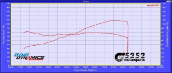

Finally got the 1150 on the dyno last night. When I was in the carbs, I was happy to see all the stock jets, needles etc. I was also curious to see whether or not I had screwed anything up! She has been running very well since I went through it over the winter but needed to know for sure. I was hoping for 100 at the wheel so I'm pretty happy. The graph says flywheel hp, but it's wheel hp and torque.

I was happy with the hp numbers but even happier with the torque numbers.

Less the aftermarket ignition, mine is basically set up like your EF. Iw would definitely be interesting to see the effect of the go fast goodies, and how they compare to the hype.
I posted this a while back to try and relate the various dyn numbers to the factory specs. The conclusion was that for a chain drive there is a 15% difference between crank and wheel.
http://www.thegsresources.com/_foru...8-GS1100-Dyno-Results-Analysis&highlight=dyno
If I use a 124 hp at the flywheel for the 1150 I get 105.4h p at the wheel which would be 3.4% lower than your reported high. The bike is obviously running well and the dyno results are a little high (3.4%) but within reasonable accuracy limits.

I never did get the manufacturer of the dyno, but even with 105.4hp I'm a happy man. Like I said, I was going to be happy with 100hp. The bigger happiness comes not from the tq numbers themselves, but the flatness of the tq curve. It feels like I can ride around in one gear all day long.

I'm kind of amazed that the peak is at around 7500 RPM.
