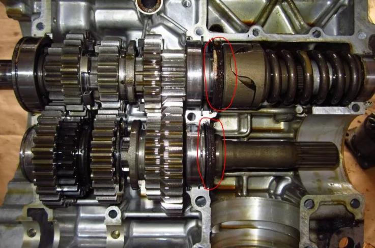

                Thanks BW, yes I was already planning on replacing all the seals. Oil pan, Clutch, Head Gasket etc. They come as a total kit. My specific question is about the seals that failed in this thread. Those 2 seals are the culprits that let oil into the gear box chamber. I have identified 1 but I can't figure out the second one.
                The first seal is part 22 and 20 "Oil Seal". On the next gear up I can't seem to find that seal, I wonder if its labeled as something else? It should be somewhere around part number #10 or #12?
                  I'm looking at parts 55 and 20 ?

                    Ok great! I was thinking about ordering part 20,22, 51 & 55
                    Anything else you think I may need on the bottom end? Thanks

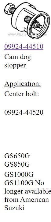

                      Just an update. I have everything taken off the bike ready to pull the engine. Gathering my parts list and I am having an issue locating this "Cam Dog Stopper" that was referenced. Does anyone have a used one LOL. It's a long shot, but the part has been discontinued.
                        What is it for?

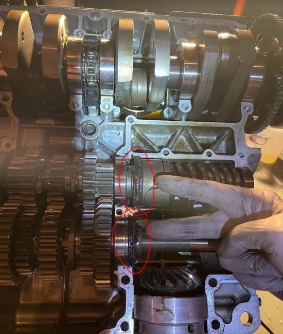

                          I had oil in my 1980 GS1000G gearbox. The internal O-rings have given out, thus oil started to pour out of the mystery hole. Long story short, I have the block split and I found the two seals. Now I need to get this "Cam dog stopper" spring off. Concerned I don't have the right tools. Wondering if anyone had any ideas???
