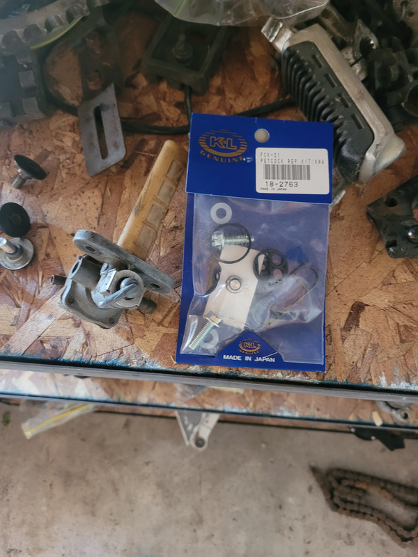

It seems now would be the time to buy a new Suzuki petcock!

Originally posted by BreakawayGS View Post... Later in the thread someone mentions do not buy K&L rebuild kits...
I really find this brand to be baffling because this stuff can be so dangerous, yet they've been in business and sold through shops that ought to know better for decades. Or maybe a bike that never manages to run is much safer. Not sure what their game is.
"Keyster" pops up now and again selling the same stuff with the same lack of quality or care. They may even be the same company; I've never figured this out.1983 GS850G, Cosmos Blue.
