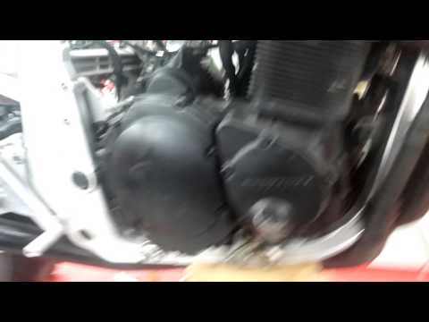

GSXR1100 is getting worked on. Over the past 2 days, started a parts list, stripped most of the bodywork, pulled the forks off and sent them out to Race Tech, cleaned up the front wheel, painted it and got a new tire mounted, replaced the battery, started it for the first time to start to figure out what's wrong with the motor.
90% sure it is a rod knock. Hope to get some definitive testing done before Thanksgiving.

Sounds fine.... If the noise bothers you buy some earplugs... Just imagine your bike is a Suzucati...You have tinnitus from being around loud noises and the ticking is all in your head...
Ray916MN
Originally posted by trlsrider View PostSounds fine.... If the noise bothers you buy some earplugs... Just imagine your bike is a Suzucati...You have tinnitus from being around loud noises and the ticking is all in your head...
Originally posted by wymple View PostDon't sound like a rod to me. A rod knock should go away under load, specifically when the revs are climbing fast, and reappear in a heartbeat when the rpms start to level out. I also thought I heard the knock in your engine miss a few beats, and a rod won't do that, IMO.
I've got my fingers crossed.
edgeofvamp
I listened to this on my phone, so I didn't hear very well.
I wouldn't say it sounds like rod knock, it sounds similar to piston slap on my phone.
Not full on, but more like the cylinder is ovaled or flared at the bottom of the cylinder bore.
It is just a guess until I can get home to my computer to have better sound quality.
Does the engine have loud valve tick or was that my phone.
The only other thing I can think it sounds like at this time is that it could be detonation, hopefully I will hear better later.

Working on the GSXR1100 more. Let's see if the knock is an exhaust header leak.
Hmmm, 3 missing exhaust collar bolts. Two stripped holes. Remove the exhaust. Heli coil 2 holes, replace the exhaust gaskets, remount the exhaust. Nope. Still knocking.....
I can do the rod knock test by just removing the plugs, so that's next.
