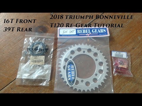

                Re-geared my T120, go to 22:30 for the test if you don't watch me yammering on...
                Running -1 in the front and +2 in the rear. The bike is now very light in the front under acceleration, pretty quick for a parellel twin.
