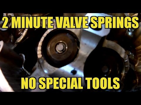

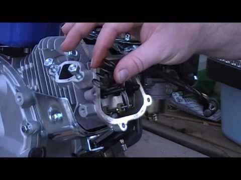

      As far as changing the seals with the head on. Theoretically it could be done by placing each cylinder(one at a time) at TDC and either pressurize it with air with a leakdown tester hose screwed in the spark plug hole as long as the rings and valves seal up well or fill the cylinder with oil and screw a spark plug back in to keep the oil in the combustion chamber. Either way should hold the valves in their seats, but the oil would be better in my opinion since the fluid would be hard to compress. It will make a bit of a mess when you turn over the engine to squirt out the excess fluid when your done and it will smoke quite a bit for a few minutes when you done.
      The keepers can be removed by striking the top of the spring with a hammer and a deep well socked of similar size as the valve spring. I've done this many times with the head off and a balled up rag under the valves. They can be reinserted with the socket by placing the keeper on top of the retainer in position and pressing down with the socket. It does take quite a bit of effort, but it can be done.
      Again I've done this with the head off. I should mention that if your not used to wrenching, it might not be something to try yourself.
      Another thing to note is if these are the original valve seals they will be a bear to remove. We had a former member Eric made a video of an easy way to do it by torching the old seals and pulling them out with a pair of needle nose pliers.
      Video of how to remove and install the keepers.
      Here is a video of someone using a rope in the cylinder as was mentioned by Steve, I think.
