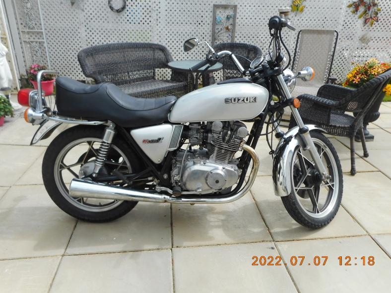

    Hi, I am living in northern Canada and recently joined. On with my 2nd Suzuki, as owned a 500 two stroke twin Titan in the past. Just turned 80 years old and have owned many motorcycles, mostly British from age 15. Have always done my own repairs, even as a youngster. I have a great love for doing to work and riding. A friend of mine was moving and offered me a 1979 SG425L, it had broken and parked for 17 years in the back garden, uncovered. been working on constantly and now have it cleaned up, repaired and running. Parts are expensive and it costs more to transport than the item costs. I find the forum very informative and DSCN0849.jpg DSCN0849.jpg thanks for having me.

    HI, would anyone know what the color this bike is, as it is still original and would like to touch it up a little. Also the oil pan is different , with the drain plug in the bottom left, rear corner. It does not have a pump filter cover. So maybe I have to drop the pan to get to it? similar to the GS450. Can anyone confirm. Thanks
      Paintcodes are the last three places of a PAINTED/or Coloured part number. Some of the later Real Suzuki Shop manuals have this info in the first pages and some parts fiches also have it...Sometimes it's even surviving as a sticker on the bike somewhere... you can take that to paint manufacturer websites and look for a match and colour swatch ...
      Good luck on the oil-pan. Usually you goto a parts diagram and compare the parts numbers...matches are few and far between for things like this.
      I go here because it's good for worldwide variants but a bit Eurocentric. https://www.cmsnl.com/suzuki-gs425_model13424/
      see if a reasonablly matching colour code shows up...(you don't see many pearl-white bikes in the world so i weven wonder if that's original?)At least it saves you being stuck in 450s

        Thanks for your reply, will follow up on the site you quoted, the color actually is more of a silver gray. It really looks original as the bike only has 16,000 kms on it and everything on is from day one except for a mirror. Great site, the forum is a wealth of knowledge for the oldies. Thanks again.
          It's hard to match paints. I'm not a restorer close counts so find myself at Canadian Tire buying what looks to be matches for something like a fender. TIP! GO OUTSIDE WITH THE CAN .-they'll generally let you. because you can never tell under neons.
          if you're into more serious stuff, you need know base coat/ primer- especially important for metallics? Some good threads and pix here somewhere...
          Chips you can do somewhat with nail polish, model paints. a Million colours. and You can mix similar types. But keep a record of how you succeeded. I keep the tops .
