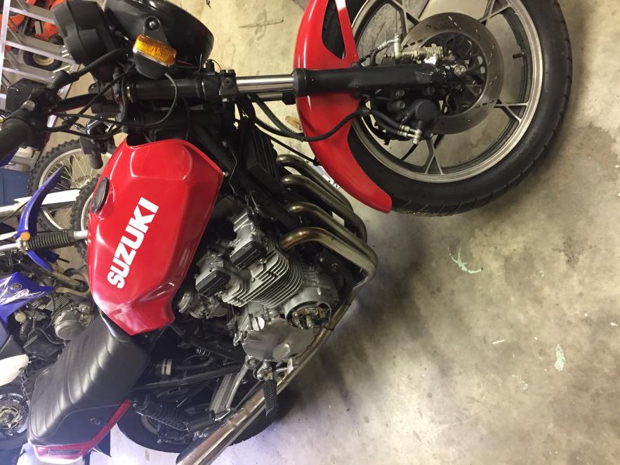

    Thankful to see there is a resource such as this online. I signed up as I just acquired a 1982 gs1100e I believe? Someone in the lifetime of the bike repainted it and decalled it as a gs1100s? I can grab a picture of the sidecovers which are removed right now and not in the pictures I've got to put up. I'm in my 40's and my wife and I both ride currently. Her on a ninja300 and myself on a cbr f4i. About twenty or so years ago when we met my wife was riding a ninja500 and I had a 79 gs750. It was pretty rough even back then, but still a whole lot of fun. So I've always had a soft spot for the gs's
    Anyways. I found this bike local to me running but in need of repair and decided to take it on as a winter project. I'm hoping to stay or get back to as original as possible to qualify for collector plates(cheap insurance for a 2nd bike up here in BC, Canada). I'm quite experienced mechanically and have a lot of tooling but haven't delved to deep into bikes. I'm really looking forward to the process and challenge of it all. I plan to do all the work/painting myself. Currently the bike runs but has a hell of a rattle at low rpm. I've been researching on that and will be checking a few things over, cam chain, clutch basket, starter clutch bolts, etc.

          Welcome, brother 11EZ owner (the "z" means 1982).
          "S" would mean a Katana, so no it looks nothing like that. Low rpm rattle could be the notorious "cam walk". I think it can be lived with, but wait another day and the experts will chime in.
          I like your paint - I always thought the '82 red was too dark. In your 40's? That makes you a youngster around here.

            It appears you have '83 end caps on your '82 motor.
            I find this amusing, because I have '82 end caps on my '83 motor.

              Baatfam, interesting on the endcaps. Mine appear to have been painted after the fact. A couple of them are chipping and showing the chrome underneath. So maybe it was just a accent a owner added at some point.
                I see what you were saying now Baatsfam. My end cap covers are the 83 style regardless of being painted or not. The lines and black/aluminum vs smooth chrome I believe?
                  Correct. I've tried both, and liked the chrome better on the black motor.
