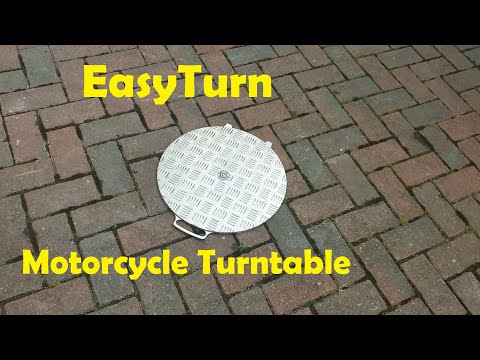

    Superb. I just picked up a couple of those 1000 .lb Lazy Susan's the make for making a center stand bike turn around. That way I figure I can drive in, offset the bikes, mount of the turntables, and just turn them around without much effort.
    @ the 3:00 minute mark, you get a good view of what he did in action:
    I would be interested in a report on how useful you find these. I considered using one in my garage but overall it did not seem like much if any advantage to just backing the bike in, I saw two potential problems. The first was that that you would have to put the bike on it's centerstand centered on the disk each time. That could be a bit of a job depending upon the bike and the state of it's suspension The second would be the amount of floor space I would have to keep clear to allow the 180 degree sweep--real estate that would otherwise be available for equipment or other bikes.
    It strikes me as something that could be the answer in certain situations but perhaps not beneficial in most. It would be educational to hear from someone actually using one.
      Mr. S. and Don, I have a very similar product I bought 5 years ago or so. (Photo below). There is no way to back in to my garage unless you have someone to help push, or a reverse gear. Our drive is pretty steep and drops off right out the door.
      As to how it worked? For me, and I am not very big guy, it was near impossible to get my GS on the stand using it. It takes away 1/2" of clearance. I finally got it on the stand, on the product, but only by parking the rear tire on a 1/2" piece of wood.
      Once it is on, it does work as expected. Of course I have a nice polished concrete floor.
      However, that polished floor created an additional issue. When I went to take it off, I couldn't push it off the stand...The stand, with all four wheels locked, just slide on my polished floor. Ended up finding something to use as tiny wheel chocks to get the GS back off.
      Anyway, I put it in the corner of the garage and never used it again. If anyone wants it, bring me a case of craft beer, and you can take it away.
      Mr. S, since the one you are getting is just to turn and not move the bike around, and it appears thinner, it should work much better.
      Probably what I should have gotten in the first place. But I've become an expert on the 6 point turn.

              The "Lazy Susans" I purchased are very thin. Since the floor is wood, I've been thinking of "pegging" them for use, and being able to remove them when not used. I plan do make them as thin as possible. My ZZR1200 does not have a center stand, because I've lowered it 1" inch with a "Soupy's Lowering Ki" and the center stand does not clear the dog bones. I have been pounding on my CAD and have come up with a way of making a center stand that mounts on the original mounts, but will come off, and I may be able to make it portable, and carry it on the bike. I have Triple AAA, in a worse case scenario.
