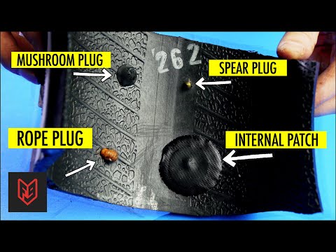

For years I just carried an aerosol can of Fix-a-Flat (similar things in your neighbourhood) and haven't had a puncture for two decades.
However, now that I carry some sticky string and back at base have a full set of internal flat patch plugs, I've no doubt I'll have zero punctures for many more years.---- Dave

Agreed. That was spot on. I wasted a fair bit of cash a while back on the Stop-n-Stay plugs, and they're utter crap. Worse than demonstrated, actually; although the "needle push" test was pretty good. In motorcycle tires, the rubber plugs usually pop out after a few miles.
Sticky string is the best by far, and the best of the best of the sticky strings are Nealey repair kits; no glue required, and they're installed in a slightly different way that ends up tying a knot inside the tire. You also end up with four strands of sticky string inside the repair instead of two, so they seem to conform to the hole better.
I carry Mini Kits on all my motorcycles and vehicles:
I've found that the sticky string plugs actually increase significantly in sticktivity after experiencing some heat, time, and centrifugal force. They sort of turn into this immovable little glob on the inside of the tire.
I've also installed "inside the tire" mushroom repairs a few times. Frankly, the success rate isn't nearly as good as plain old sticky strings.Last edited by bwringer; 02-15-2021, 04:11 PM.1983 GS850G, Cosmos Blue.
