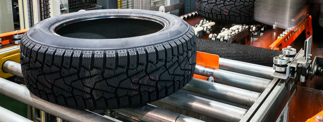

The bike looks great, but while I saw a number of upgrades being planned, I did not see the most important one: tires.
All tires harden over time and lose traction as this happens. If stored in sunlight it happens quicker.
Even if the tread appears very good, an old tire does not have the same traction and is not as safe as it once was.
Consider them as having a five-year lifespan, not from when they were installed, but beginning from date of manufacture.
Check the dates on the sidewalls and replace them if they are more than five years old
Here is a simple means of checking :

Got it covered. Dunlop 404 front and back. The same as the 11 year old tires that are currently on the bike.
