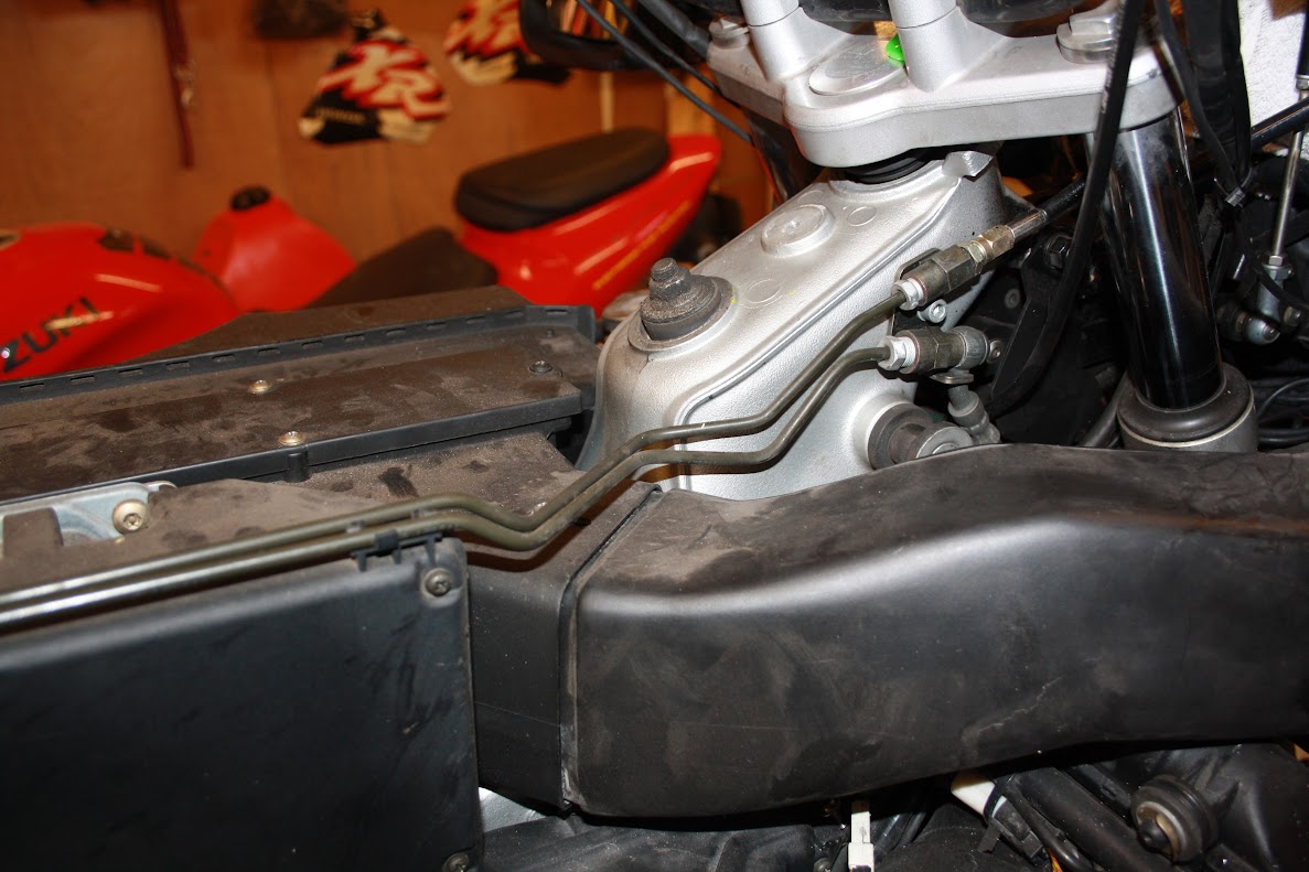

    The ABS/servo unit:
    Brake lines everywhere!
    Operating the unit, separating the electronics still needed on the bike:
    Ready for first test without plastics:
