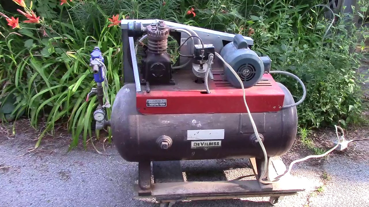

Using my antique DeVilbiss air compressor.
