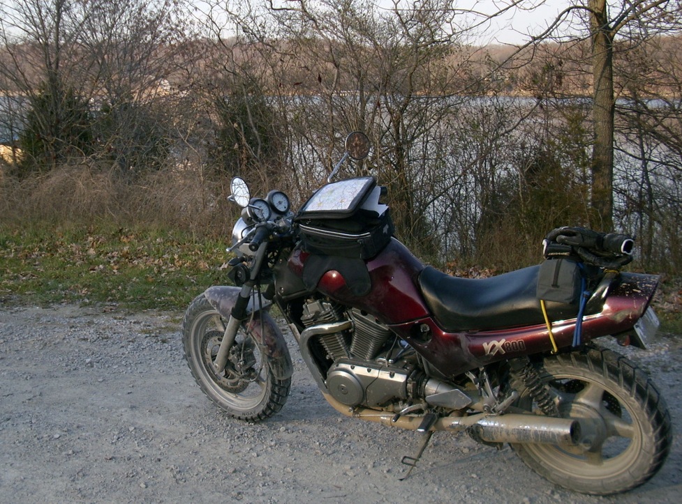

                Here's a photo I dug up of my first VX800 showing the seat. Long story, but after a crash, I installed knobby-ish tires and went adventuring...
                You can also see the neoprene boots on the forks to absorb the nearly constant fork oil leaks. It went down on this side, so there's a visible repair to the bodywork, and the left exhaust was rashed pretty good. I also had to modify the fender so I could raise it a bit to fit a knobbier front tire. It's a rear tire mounted backwards, and I have no idea whether it's even still available these days for the oddball 18" front.
