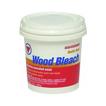

                Oxalic acid (deck wash) is an excellent derusting sauce. A small package in a plastic garbage can full of water works well.
                  As stated in the OP the plan is to take the chrome completely off or take it to the local U bast it place and rough the chrome up then paint it black.We have oxilc at work so I got some,with permission of courseMay use it to be sure all the rust is gone.
