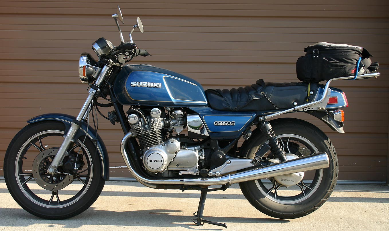

For your amusement and edification, here's a shot of my 1983 GS850G from a few years back (2005, I think) with that hideous cheapo vinyl air cushion I mentioned. The company that made these is long gone. Mine ultimately succumbed to cat claws and deterioration from age; I couldn't even get kiddie pool patches to hold any more. Fairly comfy, but it did add a fair bit of height.
