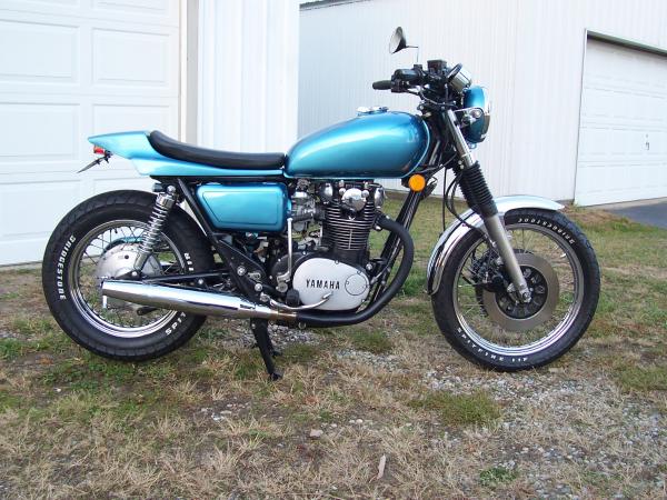

                      My 80 XS650 I fixed up.
