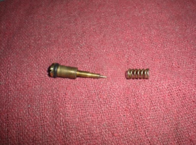

Hey guys, I ended up just getting a new set of GS450 replacement carbs. They are very clean and in good condition the only annoyance is that one of the mixture screws is missing and I am having trouble finding a replacement. Looking on Suzuki Parts House, I wasn't able to find the part number for one of these guys and couldn't find them on Jetsrus either. I tried looking on ebay, but couldn't find the exact same one. I am guessing the carbs are from a 450L, as they look like these ones from the 1980 GS450L carb cleaning guide on BassCliff's website. Anyone know the part number or know a place where I could get one?Attached Files

Have you searched eBay for 450 carb kits? Hopefully, some kit will have them.Ed
I have, I haven't found any that match it. It's weird, someone found a replacement mixture screw for my BS34 carbs in like 30 seconds while I can't find any for these BS34S carbs which were way more prevalent. This may be a dumb question, but if I find one that has the same length and width at the tip would that work as a replacement if I can't find an exact match?Last edited by gorillafan208; 04-29-2023, 06:35 PM.

Just use the screw and o-rings you need the chuck the rest, it'll avoid a lot of headaches trying to get the knock off parts to work right1980 Yamaha XS1100G (Current bike)
