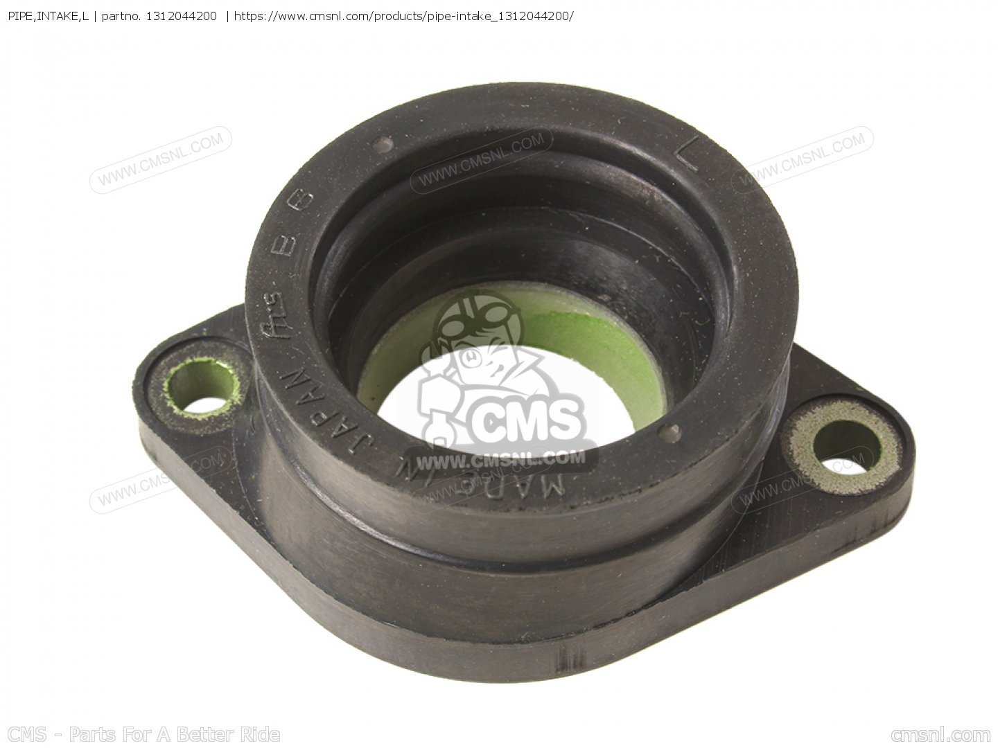

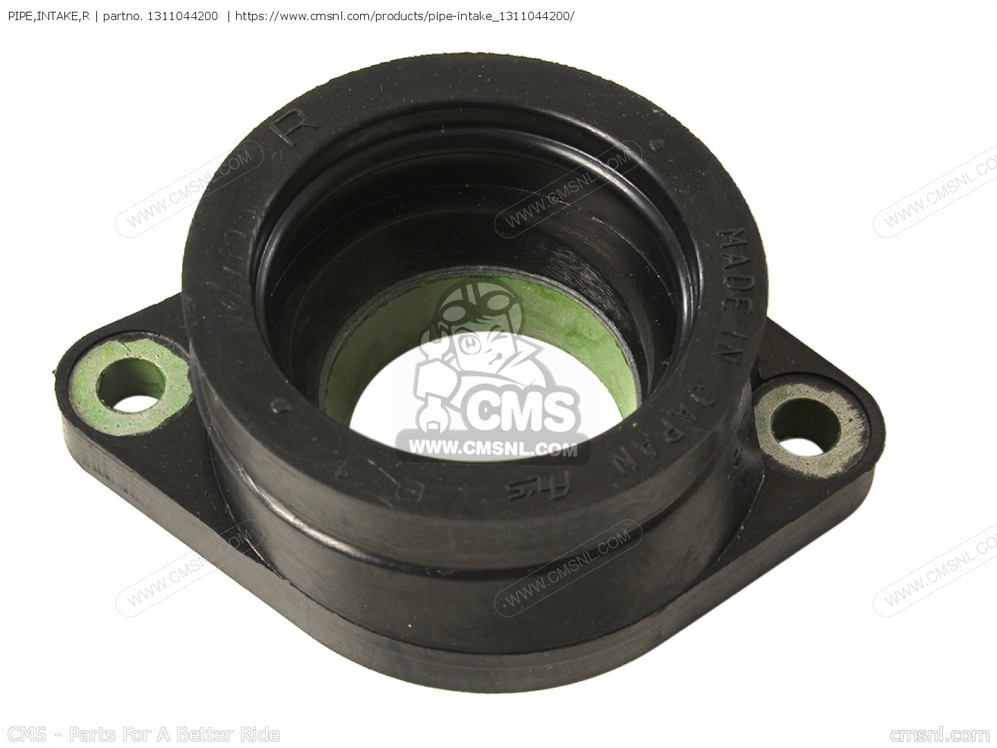

    So...it seems I may have to replace both of my Intake boots, the only problem is I can only find two websites that carry them, and I am not overly confident in their legitimacy.
    One is CMSNL, which list them here
    ✓ Get the PIPE,INTAKE,L ✓ Manufacturercode: 13120-44200 ✓ Genuine Suzuki part
    ✓ Get the PIPE,INTAKE,R ✓ Manufacturercode: 13110-44200 ✓ Genuine Suzuki part

      cmsnl is a legit parts source. Postage is a liitle pricey and they ain't the quickest but apart from that they're ok.

        Apparently these parts are massively back ordered.
        It will take more than a month to arrive, and will cost 100+. I will try a rebuild with just the o-rings first.
