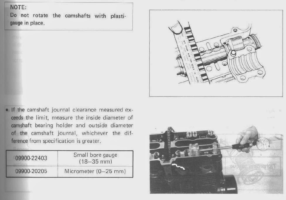

                      I read somewhere of an OCD engine builder that would set the cams in the saddles before attaching the cam chain and before any valves were installed. He would check to see that they spun nicely before assembling the rest of the motor. In my manual for the GS1150 there is a procedure for using Plastiguage or what we in UK know as Engineers Blue. This will show you where the high and low spots are:
                      Then, as it says, measure the outside of the cam journal and the inside of the saddles. Is there any difference?
                      Could also be cam run out (they are slightly bent).
                      I have never done it but there are threads here about lightly sanding down (you know with the highest grade wet and dry with water) the high spots on any saddles that are binding. You might try the Engineers Blue first and see if there are high and low spots.

                                GregT, yes that's what I tried. Everything gets oiled up and cranked down to the proper 84 in lbs as the book calls for. I just tried this with the plastigage and found that I have absolutely no clearance. The book called out for 0.15mm clearance for the cams and the only readable one was 0.05mm BARELY. The rest just squished out and was not measurable. So now knowing this, Idk if it's the head that's warped because that should effect something that bolted down over a long, continuous plane. I'm bolting it down in only 2 spots and if this plastigage is showing fairly consistent "no clearance" readings, then something else might be causing this. The only thing I can think it might be is that when I used that 3M abrasive rubber bristle to clean up the gasket surface, I must have removed too much material. I tried to be SUPER carefull with it but any touching must be too much touching and now the caps clamp down too far. So it looks like either shims, or a new head and completely rebuild that one :/
