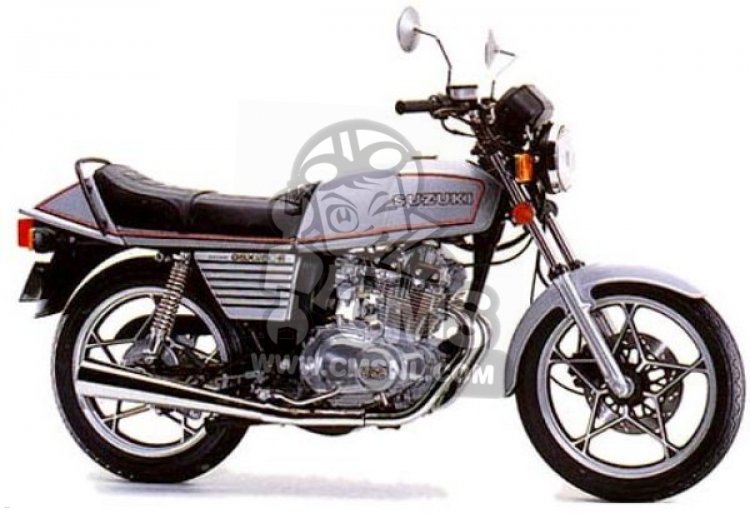

      Is your bike like this?

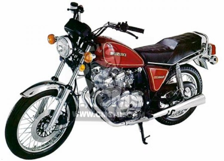

      and here is a US model GS250T
      Both these have square camcovers and that indicates 4 valve per cylinder engines. "GSX" in other words.

          Gorminrider: Yes, my bike's like the one in the first link you posted, with the square tank.
