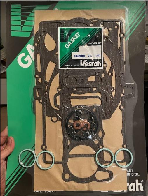

      I have a Vesrah Head Gasket coming in this week. I have the engine out due to another issue with the secondary gearbox. But my specific question is when installing the Vesrah Head Gaskets, do I use any silicone/ sealant with the head gasket? Or just the gaskets by themselves? Looking for direction. Thank you!
        I spray them with Hylomar.
        Other people don't.
        I don't care about other people's opinions on the matter.
            Other people don't.
            Spray both sides? Also spray Both Headgaskets? Upper and lower?
              Yep, just a light coat on all.
              However, there is one that I don't know that I would - the multi-layer steel head gasket. The makers of those say they're already coated and no further coating is needed.
                Do you know if Vesrah brand that has "multi- layered steel" ?
                  I'm with Ed on this, dry is the way I have always done it, I had a base gasket leak on my dirt 1000 and replaced with an oem and the new tear drop shaped o rings and in this case for good measure I used three bond. The three bond (far superior than Hylomar) caused the gasket to slip and squish out, So I did the job again using less three bond and because I thought at that time it was the fault of the o ring, (I had doubts about them being OEM) but same thing presious hard to get oem gasket squeezed out.
                  After managing to source another OEM gasket from the US the first one arrived broken because it was dry and brittle. I managed to find an 1100 oune that needed trimming this time I roughed up the crankcase and cylinder base and replaced dry. End of problems. My fault for trying to be clever and putting the three bond. I've done heaps and heaps of these over the years never put goo on them and never had a problem till I did. .A waste of hard to come by gaskets as none are available anymore including the multi layer steel, I cheated and used the MLS one again and it's fine. I understand that Cometic gaskets are good replacements.
