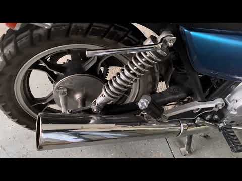

    I just put in 4 new B7EA plugs, went for a 1/2 hour ride. No change. Here’s a video of what she sounds like. After the bike cools down I’ll pull the plugs and post a pic. I think it’s just about beer:30.
