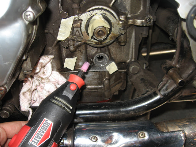

So after much elbow grease and way too much time, I got the oil seal out (rotary tool, sharpened screw driver, makeshift pry bars etc.). I guess it had a really really good seal. Bad news: the bore is now scratched up a bit. I sanded (by hand) down the roughness a bit, and all the new seals have been installed (dipped in oil first, pushed in and then #2 gasket added on top). Clutch rod oil seal was too easy to remove compared to the gearshifting shaft - did it the recommended way with 2 drywall screws.
Watch out using the rotary tool! Flying sparks started to burn my rag that was protecting the inside of the crankcase... I tried to get it and pushed it in by accident. I am glad no fire started!

Oil rag incident.
