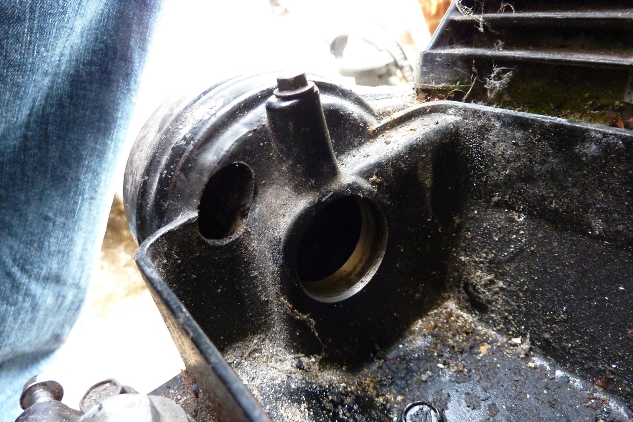

    So I am preparing the engine for a big hose down and came across these holes. Do they need plugging?
    Full story on my blog: My GS1100 Blog

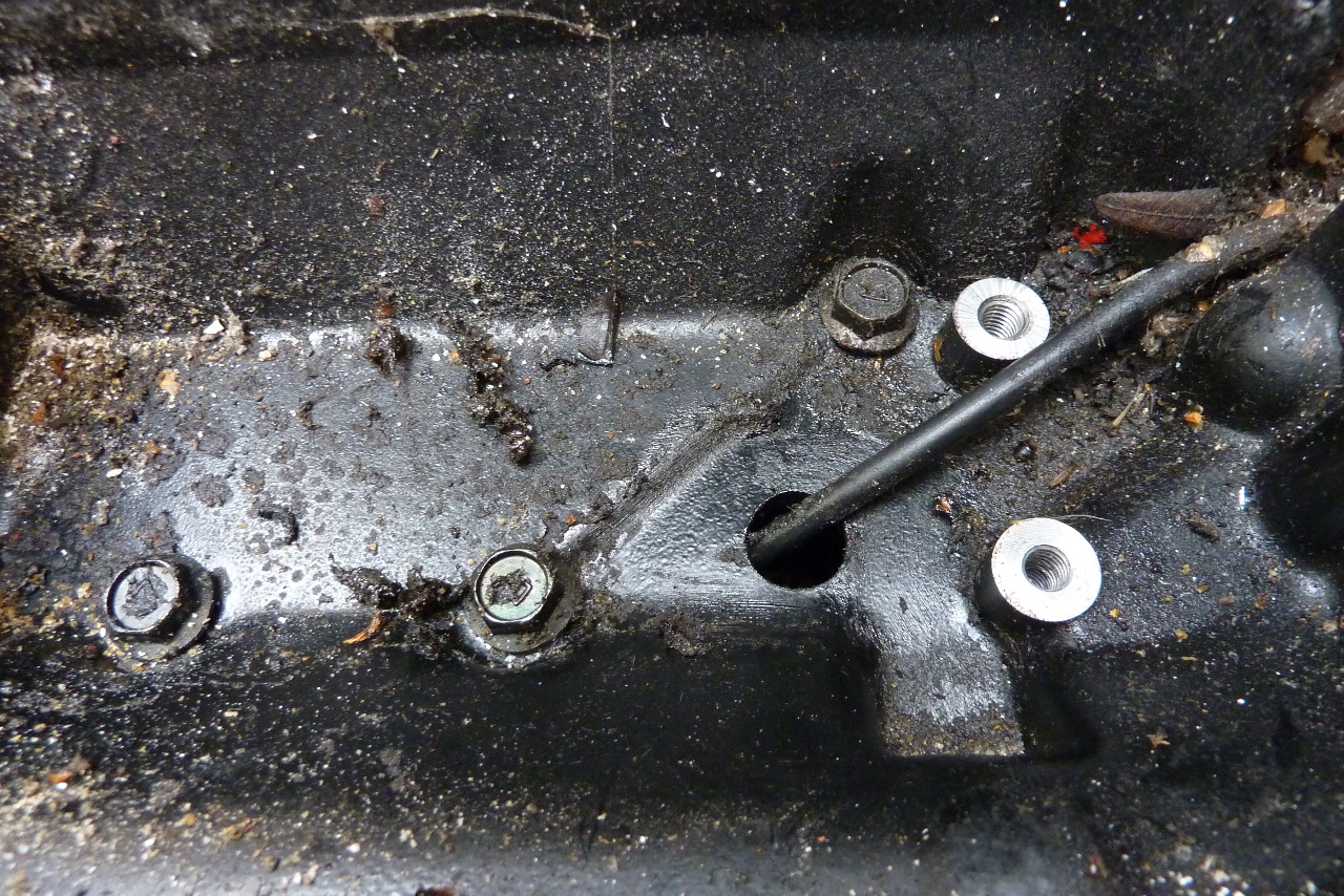

    Firstly if you take the starter motor out there are two potentially dangerous hole. One directly under the motor (it has a little pipe running into it) which looks like it goes straight into the gear box. The other is just above the hole where the starter motor cog goes into the stator housing.
    I just can't image that it is good for water to go in these holes. But then I can't see why they are designed into the engine either. Any ideas?

    The starter holes YES The other one is the mystery hole not necessary

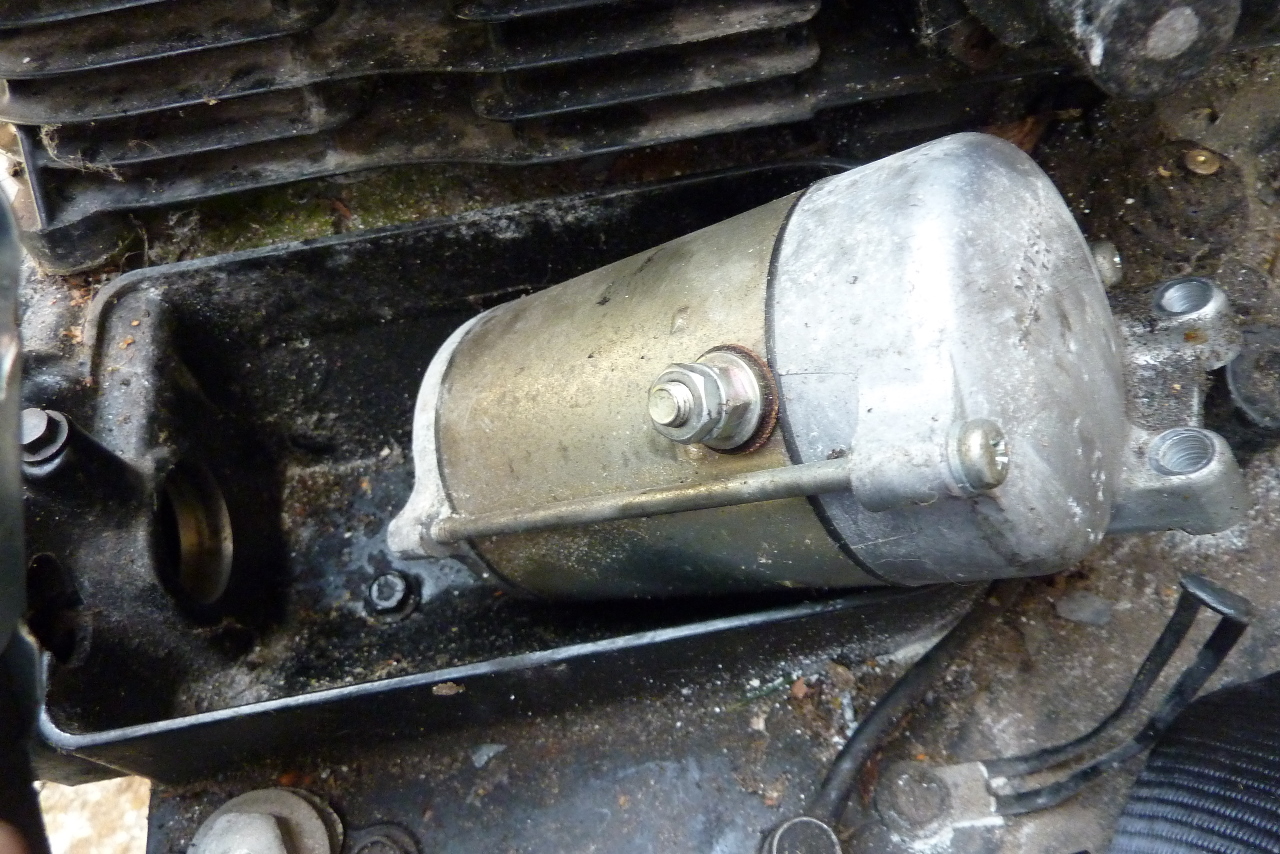

      Thanks for your reply. I have put the starter motor back in but there is still the hole underneath it (which surely can't be waterproof) and the hole above the starter. Looks like it goes through to the stator housing and I don't want water in there.

        The two holes into the stator cover are plugged when the starter and the stator wires are installed. The lower hole is there to drain water out of the starter area, it just dumps out underneath the engine.
          tkent02 of course! I tucked the stator wires under the stator coverto keep them out of the way and of course it leaves a hole. Doh! Ok I will take that one up.
          As for the other one; that is good news. I haven't turned to engine over yet to know what it looks like underneath. I thought it went straight into the gear box.
