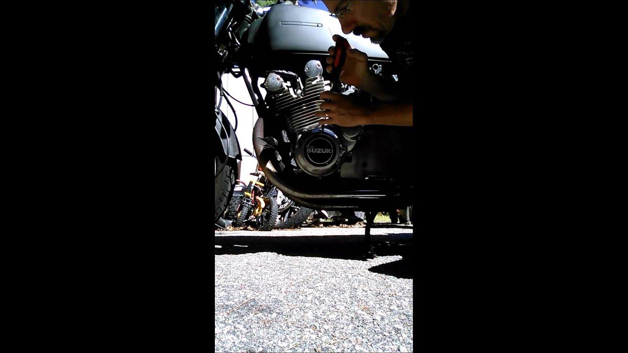

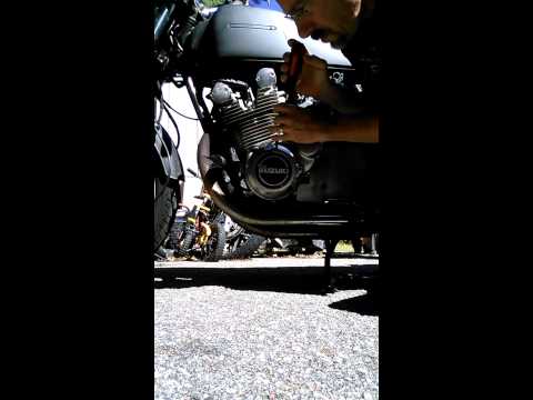

    I've got a video I'll try to load or link...
    Anyway, I'm seeking opinions about what this new noise might be.
    It starts shortly after warm up, emminates from the stator area or starter maybe? Goes away for a while, comes back... sounds like rotating metal on metal (duh.)
    I know I'll have to open it up - but thought I'd ask suggestions first.
    Thank you much for any ideas.

    • justin caise
      Link fixed thanks. Definately going to have to open this up before I run it again. Will let the people know.

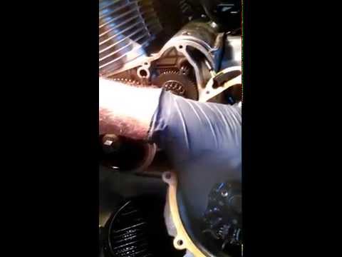

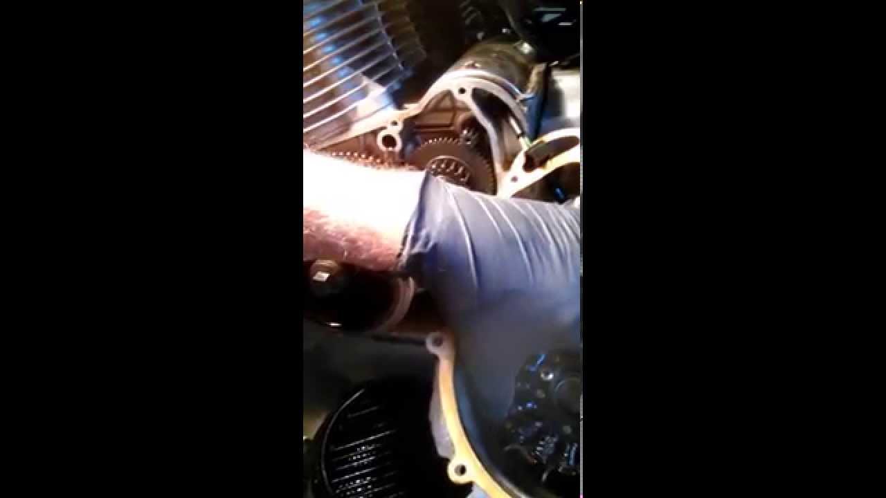

          Well, I opened it up today after draining the oil - I found no shrapnel, and no loose parts floating or falling. The video does show a slightly loose stator which I tightened down. I'm thinking that was the problem, but I have no oil to refill with so testing will have to wait. (The big question is whether or not I have the nuts to ride this from Southern NH all the way to Brooklyn NYC for the Brooklyn Invitational on the 20th.)

          • posplayr
            • Dec 2007
            • 23673
            • Tucson Az
            Look inside the rotor, I bet you are polishing those magnets. In generators and motors there is something called air gap. It is the gap that the magnetic flux has to pass through which is air. The smaller r the Gap is the more flux and more current. You definitely donot want that stator floating around. It also looks fried so you want to change it anyway .
