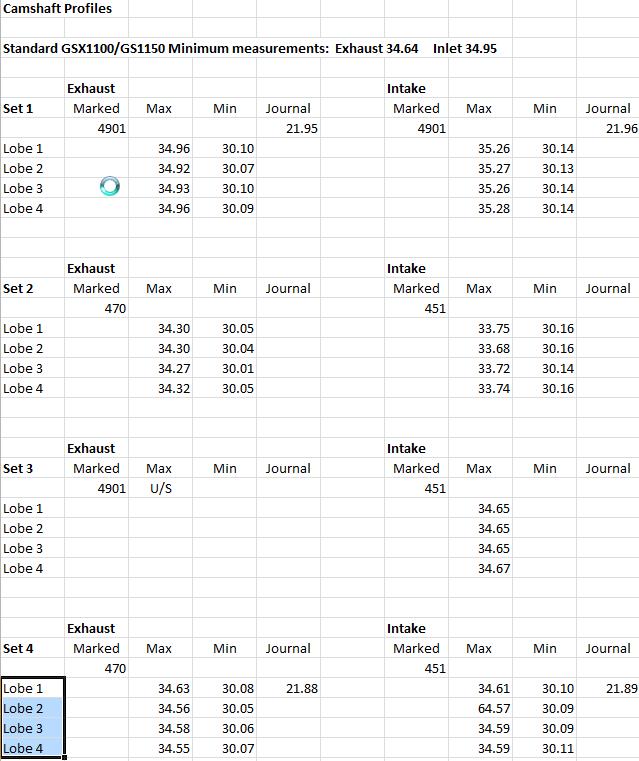

    They all had different markings and measurements. So I made a little table of the results:
    This is where I am totally lost.
    1. Set 1 has higher lifting intake lobes that it has exhaust lobes. Set 2 has the reverse - higher lifting exhausts. Something funny going on here. Which is correct? The manual shows that the inlet cams should be higher.

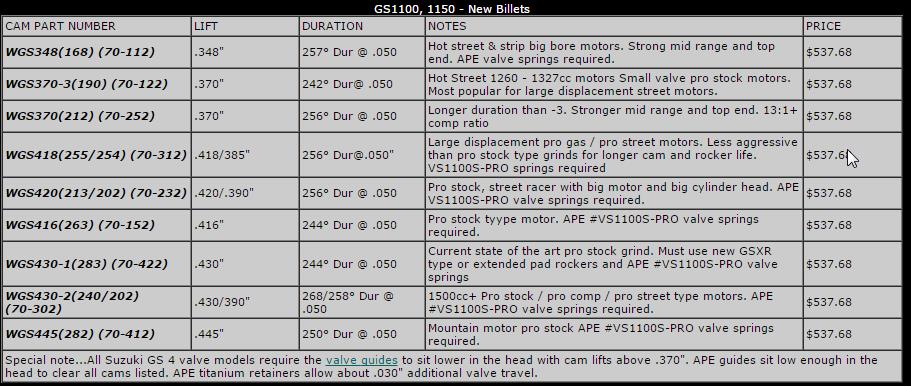

    2. Set 1 exhausts measurements are higher than standard (as displayed in the manual) exhaust measurements. So I am presuming they are "hot" cams of some description. But how do I compare them to the measurements you are given by the likes of APE like this:
    Even if you take the maximum lift of the lobe away from the core diameter of the lobe (ie. 34.96 - 30.10 = 4.86 mm or 0.1915") you don't get any figures that match anything that APE does.

    The lobe height is the diff in min to max is multiplied times a rocker arm ratio like 1.5:1(IIRC) . There are various opinions on what that number is. Except for wear the lifts are generally every 1/2 of a mm. I have tabulated the various specs in a thread.
