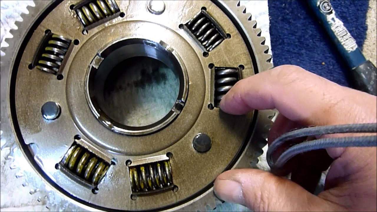

              Clutch "chatter" can be one, a combination, or all of the following:
              - incorrectly adjusted clutch
              - loose clutch hub nut
              - outer basket play on the gear box spline, especially if your basket has the steel insert like this one:
              - rattling springs on the outer clutch backing plate (unlikely to be the rivets - you would be really in trouble if it was):
              - little rubber "anti-chatter" bung missing or damaged like this:
              - lateral play as a result of the clutch hub spacer being slightly wider than the clutch hub. This problem was sort of cured on the GSX1100 / GS1150 engines by using a variable width shim to take up the slack.
              Just some of the reasons they ALL rattle. Here are some of my clutch rattle vidoes:

                Just so you know, those little rubber dowels have NOTHING to do with clutch chatter. I've been building & racing 1100s & 1150s since they were new. I've also been building clutch hubs almost as long.
                Ray.
                  Fair enough. Stand corrected.
