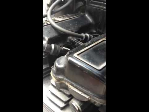

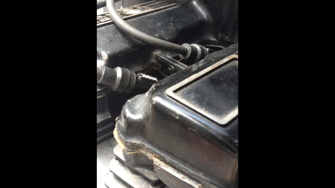

    My 1985 550e sat for the majority of last year and I finally got it up and running today. Unfortunately it has developed a tick in the left side of the top end that I would like your guy's opinions on. I know people say these 16v TSCC are noisy motors but this is worse than noisy. Video down below.
    Last year the valves were adjusted by a shop. It did not sound like this after the service. Today I ran the bike for a few minutes and it was ticking. I then changed the oil and ran it for another few minutes. It was still ticking, and the speed of the ticking correlates with the rpm. After running for a bit it seemed to quiet down so I took it for a spin up the street and the ticking came back.
    I'm not very comfortable working with the internals. I was thinking I'd pull the valve cover gasket and poke around a bit looking for the source. Any tips on what I should be looking for?

    Sounds like loose tappet (or sticking valve ). Odd that it started doing this after its nap.
    Remove camcover and investigate. Good time to make sure camchain tensioner is still able to move out against chain.
