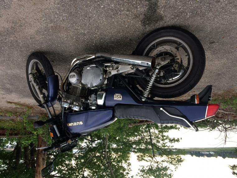

                      This bike had rust on every fastener and a seized chain when I got it. It's downright fun now.
                        AND antigravitational as well....LOL
                          iPhone issues.
                            Very nice bike. Gives one a certain pride when returning what other had written off to a state of useablility again. Then the reward of her returning to the open road with you as the pilot...cant beat it !!!!
