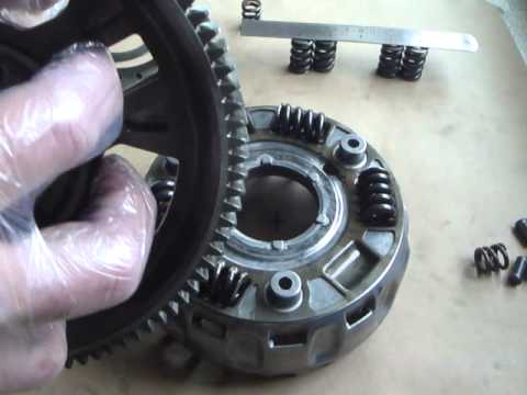

    Why don't you take some time out of an otherwise dull day to pull the clutch, and make some measurements? It's probably not what you are thinking.
    '83 GS650G
      Your clutch springs hold pressure on the plates and discs. If they are not doing their job, your clutch would be slipping. It may be the damper springs in the back of the basket, but you wont be changing those out in a two hour job. This isn't your clutch, but they are all basically the same. You might want to watch it.
