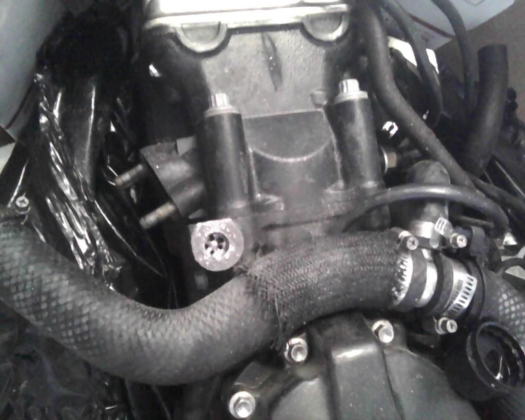

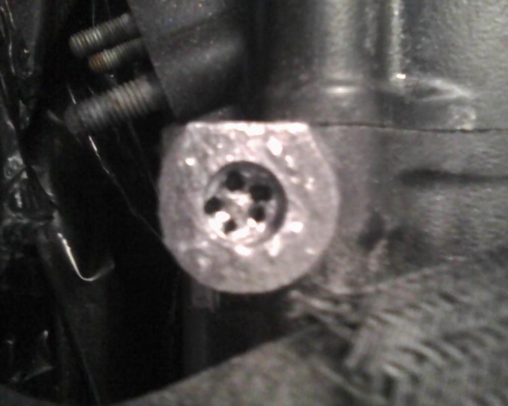

First I should start with the story I picked up a 95 gsx for cheap looking to make a buck on it. I could only start it by spraying gas in the air filter I have all that fixed no more than a few vacume leaks. But their was a bolt broke off in the exhaust and I'm looking to get top dollar considering it holds 195 pounds of compression. The problem is when I went to extract the bolt the extractor broke off in the head witch is entirely my fault I did not get the head hot enough. But this is my question I have been doing some research and I noticed the head gasket is the same from 1988 till 2006 can I take a head from a 98-06 and bolt it on this bike? I know a lot of you race so you would be the first ones to know.Tags: None

If the extractor broke off "centered", maybe some tiny cobalt bits drilled patiently around the extractor would help free it.
Then try a left handed bit where the extractor was if it was deep enough. Kroil or PB Blaster on the threads.

I used a center punch and cobalt bit to start. The bit wandered off center due to the way the bolt snapped.
I drilled about 1/4", then tried a left hand bit. The submerged remnant screw rose up outta the hole and all original threads were intact.GS\'s since 1982: 55OMZ, 550ES, 750ET, (2) 1100ET\'s, 1100S, 1150ES. Current ride is an 83 Katana. Wifes bike is an 84 GS 1150ES

Thanks for the input I agree with the head being a expensive swap I'm going to try a # 42 drill bit around and put a over sized stud for a f150 witch has a 8mm stud and is 9mm on the head side. The reason why I wanted to do the head swap was because the 95 get uses tappets and the newer models use adjustable rockers it cost me a hundred dollars just to adjust my valves on my 850 not including gaskets. Just easier for the next owner
Carbide burr in a angle die grinder and a steady hand will do the trick. Works for me anyways.
