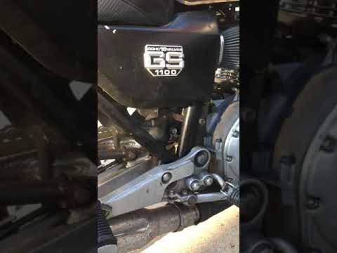

in the past weeks since riding, I’ve been finding oil spots on the ground where I park the bike after a ride. Oil is coming out of the engine breather hose, which exits into a small filter that hangs right above the swing arm pivot.
Most of the time I’m riding less than 10 miles at a time in Chicago weather (below 35F), and the oil spot is small. Today I rode it hard for 30 miles on the highway and when I came back to the bike after work, there was about 1.5cups of oil that had been pumped out.
Initially I thought it was just bad quality control, and me overfilling the engine oil, but after weeks of this happening, it seems like something else is to blame. I checked the oil level after getting home this afternoon, and the level is below the F mark in the sight glass.
aside from user error and overfilling the engine oil, what might be causing this?
bad rings leaking exhaust pressure into the crank cases??
need to do a compression check this week, but it was good (all cylinders about 145psi or so) before winter.
will try to get some pictures up soon. The top of the swing arm is covered in oil, and the oil flows down the left side and drips near the rear axle while the bike is on the side stand.
