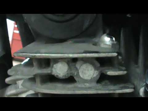

    Right now I have an engine knock that I can't figure out.
    It sounds like this:
    My spider sense says its the front side and valve height of the engine. IDK.
    Not obvious on the video but if I increase the RPM the knock disappear. I can't ear it any more anyway.
    Any thought?
    I did redo 3 shims. All the cam clearances / shims are within specs except one that is borderline tight.
    After hearing the noise the first time I opened the cam cover and can't see anything obvious.
    No screwdrivers or metal chips anyway.

    My hearing stinks...but since you said this...
    "spider sense says its the front side and valve height of the engine. IDK."
    camchain hitting something on cover at low revs? Chain slop? Is tensioner ok?
    Change that tight shim, recheck others...

      Hi tom203,
      Thanks for the reply.
      I have checked the chain and the tensioner both seems OK.
      Also inspected the cover to see if any gouges appeared. Nothing is amiss visually in there.
      Checking the clearance is good and so is changing that one shim for thinner is good practice and I will do that.
      But I have changed shims many times before. This doesn't fit.
      Other works I have done is to replace the gasket on the L/H cover as well as the starter.
      audibly it doesn't seem to come from the side but I will check them too.
        I'm not as experienced as many others on here with these bikes, but between the sound and the above quote, sounds like the cam walk our GS's are notorious for...

          My "cam walk" was much more "regular" in beat but the tone of it was very similar....you could easily find some examples searching this forum or you-tube.
          I have a nice mp3 of mine but I haven't been able to trick this site into uploading it.
          Perhaps a sticky valve?
            Sounds like cam walk to me. However like previously mentioned, my 850 is more rhythmic. It goes "knock knock knock... ... ... knock knock knock... ... ..." etc.
              Another vote for cam walk but as said the 850 is more regular.

                Sounds like slightly more regular than normal cam-walk, but cam-walk all the same.
                The absence of it when you rev up just a little pretty much backs it up - they all do it that way.
                You're probably worried about why it's started doing it now, if it wasn't doing it before.
                The answer to that lies buried with the designer. Many people have tried holding seances to get the answer, but he just won't budge, all you hear is hollow laughter, or possibly cam-walk rattle, distorted by the aether.

                  So Cam -Walk it is then.
                  And yes Grimly I have had the bike for 10 years did 80,000Km (60,000 odd Km at purchase) and it as done many weird thing but not that one ever.
                  I will learn to live with it.

                    If you've recently loosened up the valve clearances the cams may now have the space to walk that they didn't have before.

                      Good point.
                      But we loosen the clearance every time we replace a shim....
                      Mind you that at it's venerable age none of the clearances are equal. There is always a few on the tight sides and a few on the loose side.
                      Maybe it's the first time that I have one of my cam with all it's clearances loose.
