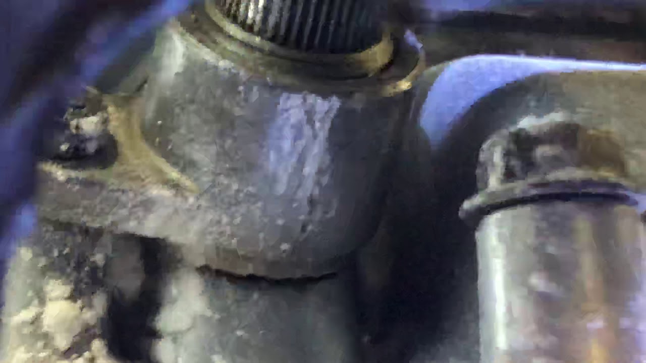

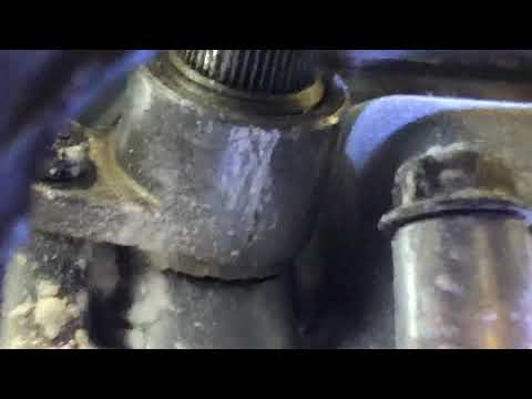

    500 miles of dry riding after my valve adjustment and new OEM Gasket, I've sprung a leak. At first I was sure it was the tacho drive seal that I neglected to change out when I had everything apart. The bigger one in this pic:
    There was definitely oil coming from around the base of the tacho drive housing. So I went to my dealer and they surprised me by having one in stock. I swapped it out. along with the small o-ring 'cause why not?
    Cleaned everything up, put the bike on the center stand and fired it up. In a short amount of time i was still getting drops of oil dripping from the the valve cover gasket on to the header below and smoking. But it was hard to tell exactly where the gasket was leaking. Then I remembered reading about using powder to find gasket leaks. So I cleaned everything up, let it sit and dry for a day and powdered the gasket area all along the sides and front, even at the half moons. Here's a short video which shows the leaks, I believe just below and to the right and left of the tacho drive. Of course it could be one leak that runs along the gasket and drips from more that one place.
    The valve adjustment I did was my first ever attempt at this. And I thought that I did it very carefully and correctly (except for the neglected tacho drive seal already mentioned)

      On your video, that gasket doesn't seem to fit very well at the ...the "cam-chain tunnel"? Is there a lot of overlap? There shouldn't be any overlps sticking out on a gasket you bought.
      so..ideas...if I've observed correctly
      A)Best guess: it's the wrong gasket? Not sure on your bike but on mine, the valve cover changed between 81 and 82 and it's easy for someone to give me the wrong one...double check changes in part numbers on an online parts diagram to see if this is possible....
      B) it's almost possible to get the gasket back to front...it won't quite fit-it'll look wrong...

          AFAIK, I have the updated gasket. I think the newer design has more bolts, correct? Everything lined up fine, but your observation about the corners of the gasket at the "cam-chain tunnel" at the front is the only place I could see that there was any over-run of gasket. I don't recall what it looks like at the back. When I first placed the gasket in wouldn't go over the 2 alignment dowels (oil chases?) until I flipped it what I thought was the right way. At the time, I believed it was the only way the gasket could go on.
          I just found a picture of the gasket on Amazon that tells me that I was wrong. I should have spun it around 180 deg, then the round part would have been at the front, putting the square part visible in my video poking out the front, to the back.

              Taking another look at the gasket picture, rotating it 180 deg. would put the squared bit at the back but would put the 4 center holes would not line up. flipping it front to back would mis-align those holes and also the LOCATING DOWELS, which are the far left and right holes in the picture. so now what?

                          OK. So I had some time tonight to pull the valve cover and inspect the gasket. The grease I used seemed to to a good job of making it easy to remove. But i found two serious tears and mangled gasket where the powder showed the leaks and a tear on one of the left front bolt holes as well.
                          What the pics show is that I evidently had some problems when tightening the bolts initially around the front part of the engine. I'll have to be more careful when I get the new gasket. I'd like to think that I would have noticed the gasket moving so much the first time. But it was exactly that, my first time. Any more advice on installing the new gasket to make sure it stays put and doesn't squirm around as I tighten the bolts? I know to go a little at a time working criss cross from inside to out when tightening the bolts.
