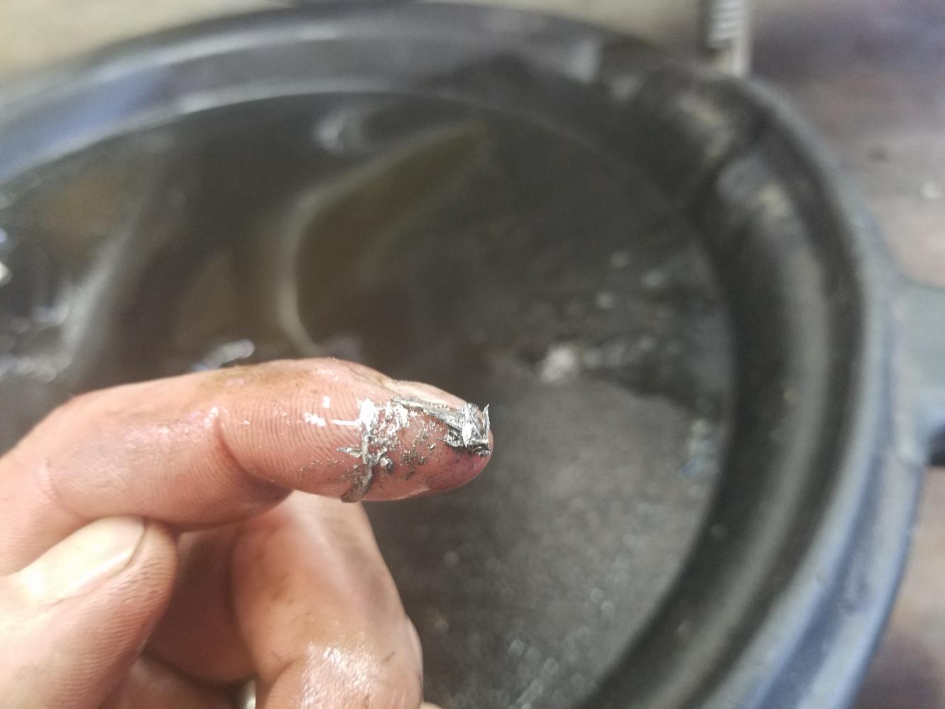

    Next I pulled the other sides cover to get a look at the starter clutch. I dont have a flywheel puller and of course either does the dealer in my area so I will have to order one. What I can see is the 3 bolt ends coming in from the back of the flywheel 2 of which are almost backed out....3 one is some what loose as well. I can move the starter clutch somewhat independent of the flywheel and there was a little bit of metal filings (not an ungodly amount) on the flywheel magnets yet I cannot see anything bothered up from around the sides with a flashlight that stands out. So I know I need to get in there to see what's what and tighten everything up but what's the opinion while I wait for a puller to get to Alaska in the mail? Would this cause the bottom end rattle I'm hearing? I took some videos but not sure I can get em on here but I'll give it a shot.

      Yes, the loose screws will create a lot of noise
      Get some 10.8 hard replacement bolts and use red locktite when installing.
      You can pull the swingarm pivot bolt and use that as a puller

            To elaborate, put your bike on the centerstand and extract the swingarm pivot bolt.
            Remove the left side cover, and the nut holding the rotor.
            Insert the pivot bolt into rotor and tighten till the rotor pops off. You can do this because the pivot bolt is the same size and thread pitch as the rotor (what he said)
            Do not use a jaw puller or hammer on the rotor. You can tap on it with a rubber mallet
            Is it that easy? maybe not. The rotor is often stuck on there pretty good after a few decades.You may end up getting the puller anyway
