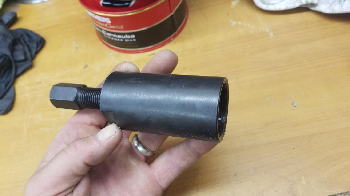

                Originally posted by dweller View Post
                Great advice guys, thanks. What type of puller are folks using? I have several styles.
                I got mine off Amazon...
                              Would you happen to have a model number for that puller? Thanks
                              This is the same one I ordered. I searched the description on Amazon a d found one there but didnt save a whole lot by doing so....this one is on Z1's website.
