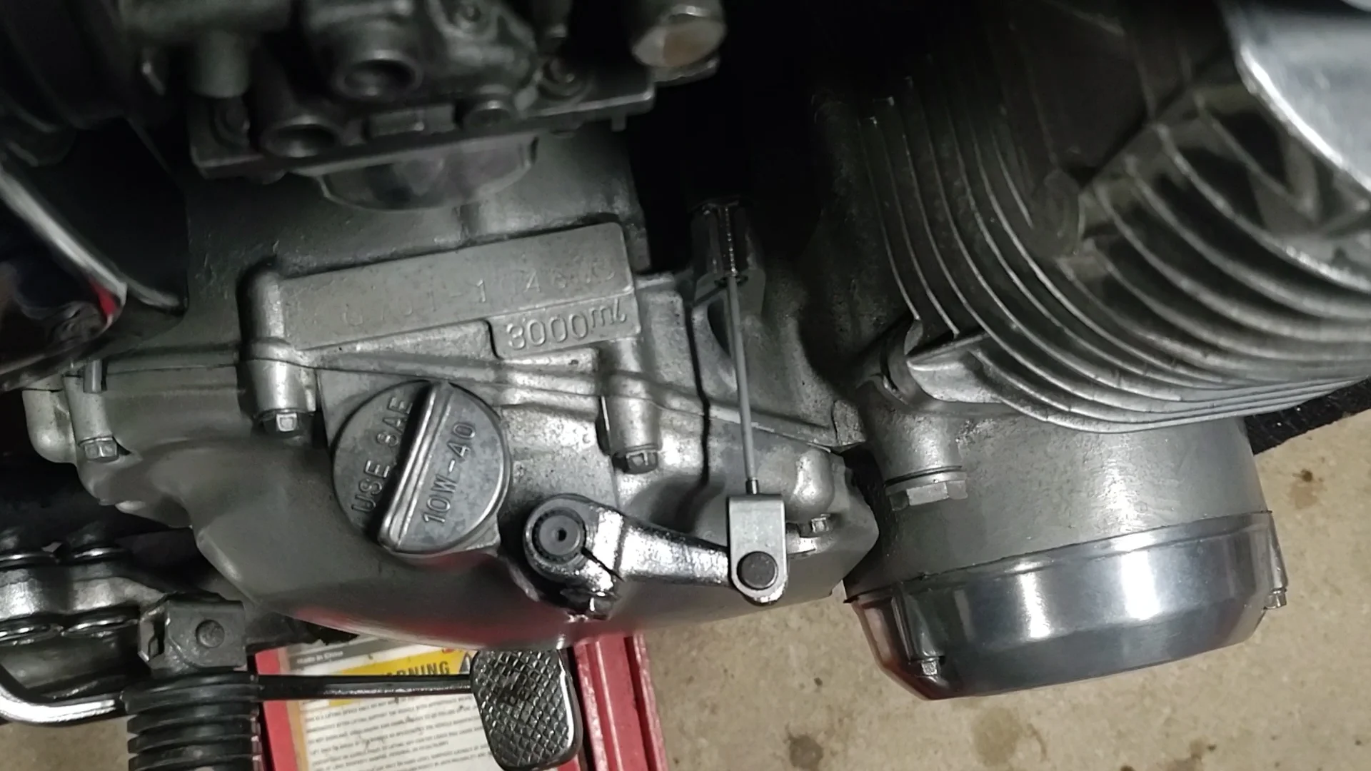

    Would this be the bearing that would be failing in the scenario you are talking about?Screenshot_20200911-171001~2.jpg
    1982 GS1100gl
      The noise is coming from the clutch case area. I jacked up the bike so the rear wheel was off the ground and ran through the gears. It does it when I let off the throttle with the clutch still engaged. Took a video so I'll post it once I figure out how to upload it.

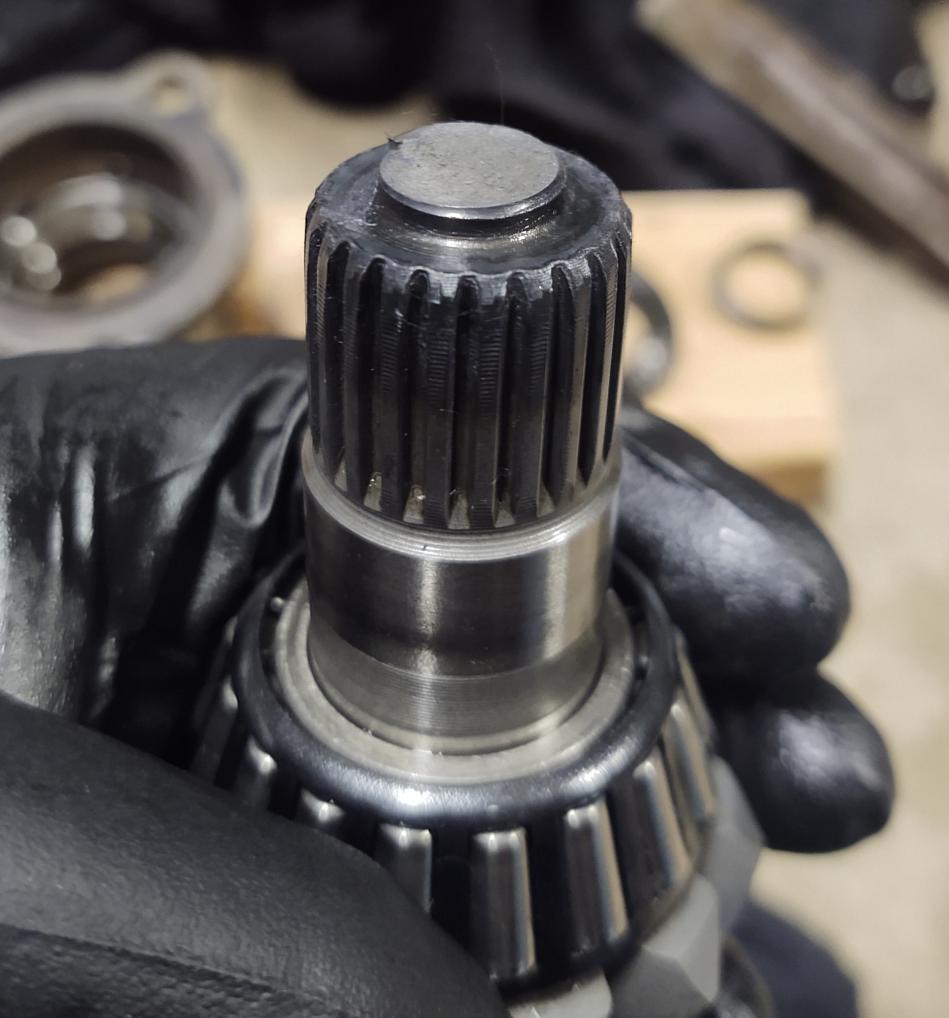

                              So I finally got around to tearing down the bike. I believe I found the cause of the gear oil sludge in the boot. When I took the pumpkin off if I tip it forward gear oil leaks out of it. Assuming the oil seal is bad so I'll have to replace that. Also going to replace the 2 bearings in it. The front one comes right off. Still trying to figure out how to remove the rear one. Bigger issue I found I think is that the final bevel is possibly broken?? I'll add a picture of it. Based on the parts schematic it looks like there should be a short nub sticking out of it. Mine is almost flush but the end of it doesn't look machined and smooth. It's a rough surface as if a piece broke off it. See picture in my next post since I can apparently only add one pic per post. IMG_20201107_181801487~2.jpg

                                Here's the possible broken end
