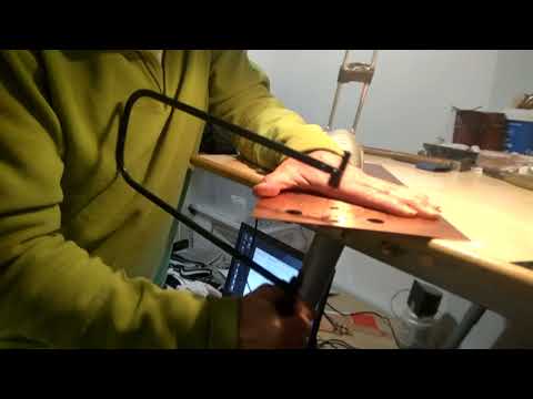

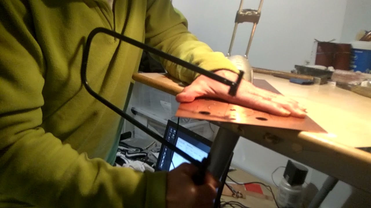

Cu head gasket

Are you going to use the rubber cam chain tunnel seal? And based on the size of the stud holes, I presume you have some seals for those too?Ed
