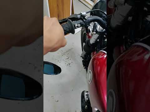

1. Idle - grinding sound
2. Idle - pull in clutch . Still grinding sound
3. First gear clutch pull in - totally no grinding sound
4. Riding along in with clutch release - grinding sound. Maybe less but I believe it's due to the rpm drive drowning compared to idle.
5. Sounds like the noise is coming from the transmission area of the engine.
6. Shifting is fine and no clutch slipping.

Can listen to the sound here:
