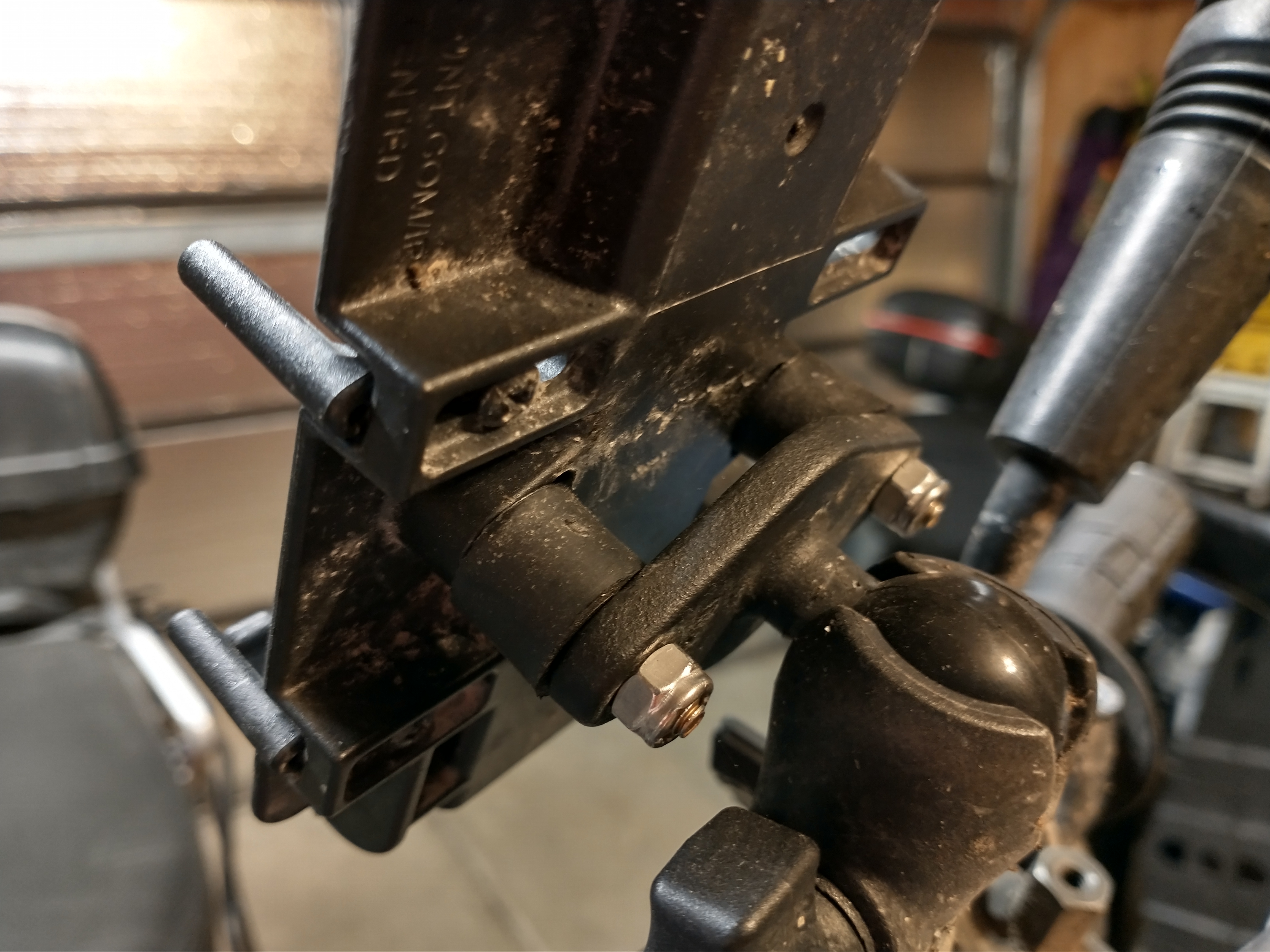

                  Behold, fine GS folks, the world's most perfect-est solution for holding a phone securely, with easy, positive in-and-out, AND protection against the vibration that will kill your phone's camera in short order.
                  Apologies for the up-close bug and off-road crusties and the fact that this is the one on my KLR. I have the same holder on all my bikes, including the GS.
                  What we have here is a RAM Quick-Grip XL, and after killing the cameras on two phones, I added rubber "sandwich" mounts from McMaster-Carr to dampen vibration. So far, zero phone issues after adding the rubber mounts two years ago.
                  The RAM Quick-Grip is where it's at -- it uses a spring-loaded claw to maintain a firm, positive grip on the phone that's immune to pretty much anything you can throw at it. The XL is the larger version, needed for most current phones.
                  The RAM X-Grip looks cooler, but it is pure fiddly phone-ejecting garbage. Unless you spend a minute or two getting the phone in just the right place each and every time, and it never rains, and you use the little stretchy net thing, your phone is going to hit the ground. And even if you do all that, your phone will exit the X-Grip at some point anyway. The X-Grip depends entirely on friction, and that just ain't good enough.​ Plus, when the phone is in the holder, the mount can rotate a bit, which will drive you nuts.
                  Here are the sandwich mounts -- the #8-32 thread matches that used in RAM hardware, and you'll need two extra 8-32 Nylok nuts if you don't have them lying around already. They go in between the holder and the mount plate.
                  McMaster-Carr is the complete source for your plant with over 595,000 products. 98% of products ordered ship from stock and deliver same or next day.
                  The OP should be able to achieve the center mounting desired with a longer mount arm, or perhaps mounting the RAM ball to the handlebar clamp with a longer bolt. There are many solutions available with RAM hardware. You'll need the holder, the plate with the ball that mounts to the holder, a mounting arm, and some variety of a mount that attaches to your bike. Most bikes can use a handlebar clamp, but there are varieties that mount to a bolt, or mount to the clamp for the brake or clutch perch.
                  RAM stuff is even somewhat reasonably priced.
