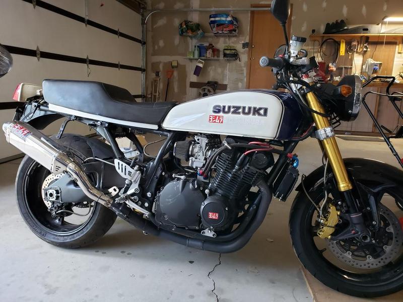

Hey gang, I'm back at the GS1000 R&D game after a number of years away. Good to be back at the GSR! Hope everyone is well.
As "found" partially disassembled when the tarp was removed from the 1000 after many years:
The bike as it sits now, with the addition of a Yoshimura slip-on (muffler bracket removed temporarily shown here), Earl's oil cooler and billet oil cooler takeoff, superbike bars, and Koso electronic tach/speedo/oil temperature gauge.
I've changed the rear wheel to a 2006 GSXR 750 for better chain alignment. More on that later...
Tail section is off until I get the bodywork repainted.
In order to improve aesthetics (hunched over stance due to short GSXR 1000 forks) and handling (a bit more twitchy/unstable than I'd like so more rake & trail needed), I plan on adding about 20 mm of front ride height via some fork cap extensions for the GSXR forks.
As it so happens, the board on the ground under the front wheel is about 20 mm high so it gives a good preview of the before and after stance.
Before:
After:
Other plans for the cold weather wrenching season include:
- Adding a heavier spring for the rear shock to match the bike & rider's weight better - currently too soft
- Fixing the leaky oil pan
- Getting the chain run perfect. I've mocked up a 2006 GSXR 750 rear wheel in the pics above to help in the effort to get the chain run straight. I was using a 2005 GSXR 750 rear wheel before and had to machine the sprocket carrier and cut down the cush drive rubbers to get the chain in the ballpark of alignment. The 06 750 rear wheel is narrower than the 05 at the hub & sprocket by about 5-6 mm without modification. Once I shim the 5/8" offset front sprocket, I hope that the chain alignment will be perfect.
- Adding a wideband oxygen sensor & gauge (Dynojet Wideband 2) to truly dial in the RS flatslide carburetors
- Paint and bodywork - needs a respray and the dent pulled out of the left side of the tank (
) after a 0 MPH tipover. Case covers need to be either resprayed or powdercoated. Currently leaning toward a GS1000S style paintjob but in darker, solid blue on top of the tank & tail.
Something along these lines:
Attached FilesLast edited by 80GS1000; 10-02-2019, 06:44 PM.
