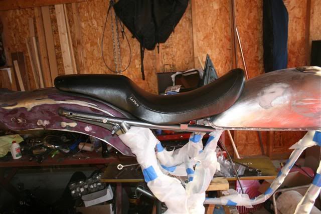

        Now, here is the seat. I'm gonna have some issues here, I think. This picture shows the seat in prime position over the fender. Notice where the front of the seat fits on the gas tank?
        Now, here is the seat where I "think" it should be.
        I think I'll be able to get there by trimming the stock seat mounting tabs, and raising the fender up a couple of inches. It may also have to slide back a little in the frame.

            Looks like that fender has got a ways to move before that seat radius will match.
            Now I'm starting to worry. I haven't worked out that detail yet.

                      Get an upholstery shop to mod the seat after you mod the pan? Perhaps much less hassle. The front molds in nicely and the rear does too. Take some out of the middle and Bob's your uncle.
                      H
                        #71
                        I agree with the seat mods as there seems to be too much of a gap with the original contours although I was reluctant to suggest cutting up a new seat (we did do it with the bikes though) but seriously, who's Bob.
                          #72
                          I dunno, I think by pulling the fender back and up a little bit it may fit just right. But what do I know
                            #73
                            This is the school of thought I will initially go with. I'm really loathe to tear up a seat in this good of shape. I think if I move the fender around, I'll be able to get it to work. If not, Harley stuff sells pretty good on EBAY, and I'll just end up fabbing my own seat. Not a big deal.
