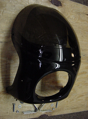

        Shoei and givi both make fairings like the one in the pictures.National cycle under sport fairings also has some fairings from the 1/4 size to ones with a dash and lights built in.May be Rifle,not national cycle.
        future owner of some year and displacement GS bike,as yet unclaimed and unowned.
          The one shown in black is a very generic fairing sold under a few labels – probably all made in the same Chinese molds. It costs about $50. You generally have to do some custom work for fasteners and the metal parts are prone to instant rust (particularly the windscreen screws). However, if you address that, these are perfectly decent functioning fairings that keep a good bit of blast off your torso – as much as my Wes Cooley, which is all I want from a fairing. Just block enough wind to reduce the strain on my arms.
          The other fairing (painted white/blue) is most probably a Meier and available in lots of places with a cutout for either a rectangular or round headlight. They look like the earliest GPZ fairings or the ZRX fairing and probably work fairly well. On the blue and white bike it’s mounted on in the picture, I think it looks like it was designed for it. Very good look.

          82 GS1100E....black w/WC fairing and plenty o corrosion and low levels of attention
            So it keeps the wind off the torso but does nothing for the head??

              You did not mention your handlebars. You will need to switch to Daytona or European bars for the fairings you show to work. You have the stock "plow handle" bars which require you to sit up straight. With them you probably would not want anything lower than what you have now.
                Good point. I'm pretty sure those are superbike bars on that one.

                    I have that "S" type fairing shown at the top, I like it a fair bit but it will by no means punch a big hole into the wind, previous posters were right when they said it only protects your chest, but when I tour long distances in 5th gear (like the trip I made between Ottawa and PEI last week, brrrrrrr, cold) I tuck in so I'm almost laying on my tank bag and put my feet on the passenger pegs, I find that position really comfortable and it cuts down on the wind: all sorts of different people like all sorts of different riding positions though, and I realize I'm probably not the model of safety. In conclusion, this fairing provides spades more comfort than any naked bike, but if you don't like tucking to stay out of the wind I wouldn't recommend this fairing for anything more than making your bike more stylish.

                      I've got one of those fairings on one of my other bikes. I like it more than no fairing. I'm 6'4". I don't really like the looks fo full fairings but I do like riding longer distances. This is a nice compromise. Barring crazy headwinds, at speed it keeps enough wind off of my body that I can release my death grip on the bars. At the same time, there is enough pressure that my hands don't fall asleep leaning forward on my euro bars. Overall, it creates a pretty good balance. Not perfect, but pretty good. Also, I paid $5 for it at a swap meet. That helps too.
