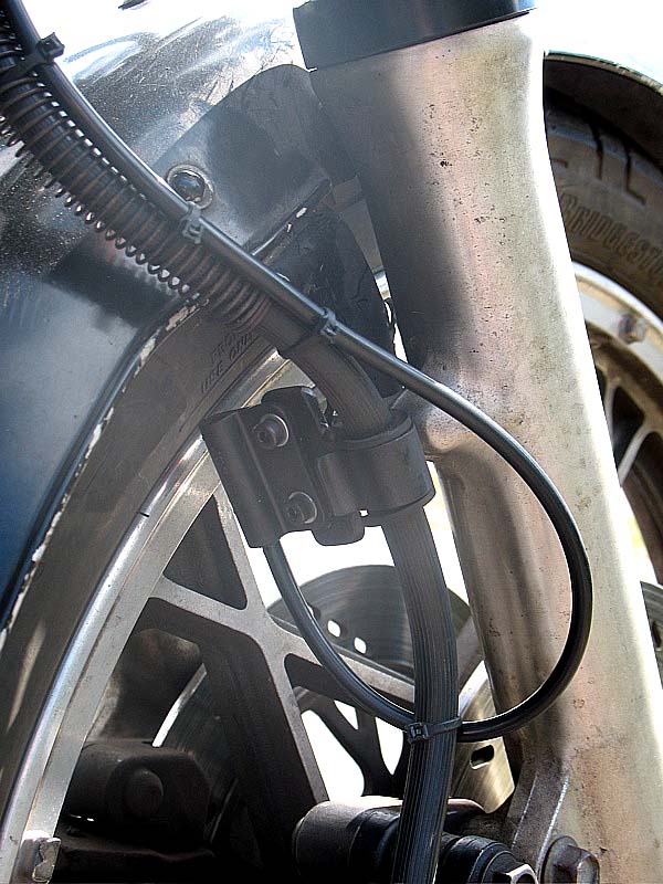

The speedo provided a bigger challenge. Acewell provides a Reed sensor and a magnetic head bolt for the speedo. However, I could not find a way to use it on the bike, unmodified. I searched and searched for a device that would convert the rotation of the original speedo shaft into 4 pulses per revolution, but couldn't find one that was cost effective (best I could do was over $100). What I ended up doing was:
- welding an extra bar of metal onto the right brake line support and mounting the Reed switch there
- JB Weld four small, but really freaking strong, magnets to the rim, 90 degrees apart from each other (PartsExpress #329-040). In case you want to try this, I found this method worked pretty well:

After I had everything together, I had to calibrate the speedo. I put a small mark on the tire and the ground and then rolled the bike so the wheel rotated exactly once. I measured how far the bike rolled from the original point and then divded by four (one for each magnet). This is the number I used to calibrate the Acewell.
How did it do? When I zip tied my GPS unit to my handlebars, the speedo on the bike was always within a few tenths of a MPH that the GPS reported, so I say it did pretty well.

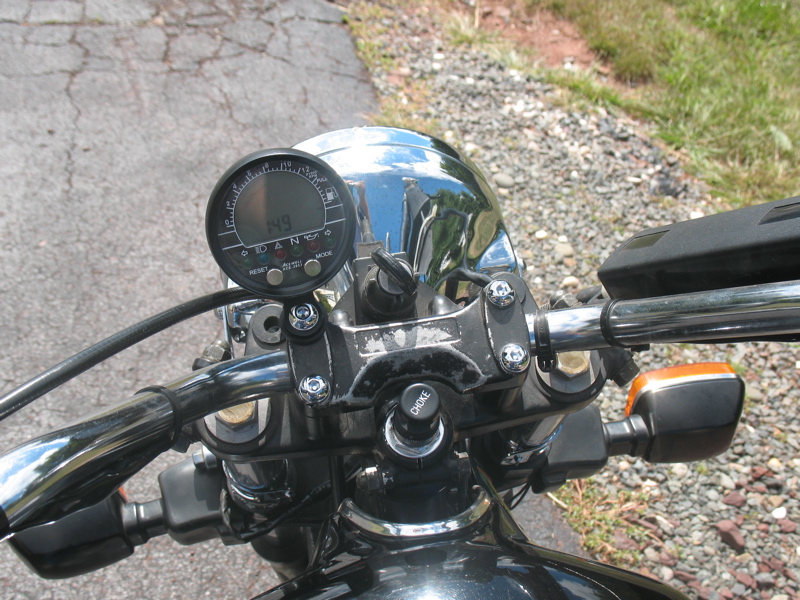

I can say that I love the new gauge. First, it is small - really opens up the front of the bike. Second, I have two trip odometers ... one for gassing up and one for knowing how far I've gone on every time out. Third, a clock ... though I can't really use the "I didn't realize how long I'd been out" excuse with the wife anymore.

Acewell:
Brake mount
You can see the two of the magnets on the rim, one close and one far. I still need to get in there and grind off some of the excess JB Weld:
