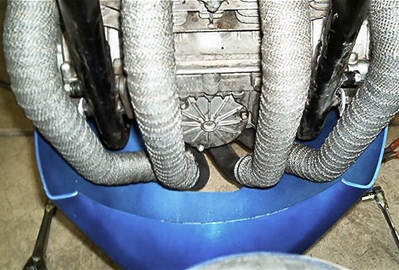

Sorry for chiming in late here, but you guys are missing a big part. They sell a header-wrap spray / coating that seals water out of the material.
Thermo Tec 12001 - Thermo-Tec Hi-Heat Coating:
Specially formulated to protect exhaust insulating wrap. Withstands temperatures up to 2000°F and not only improves header wrap appearance, but extends its life!
The beauty of this is it also paints the exhaust wrap a black'ish gray color. The white just looks goofy in my opinion, so this fixed it nicely.
Can't even tell it's there!
Last, I used the high-temp metal zip ties to hold the wrap in place. It never loosened, never moved.

My header wrap is starting to fray. Honestly tho with all the polished work on my GK the frayed exhaust just looks like a badass. Glad I did it and will do it on another bike but it does stink. Especially when the carbs leak down on it and the wrap gets soaked in has before you ride haha.
