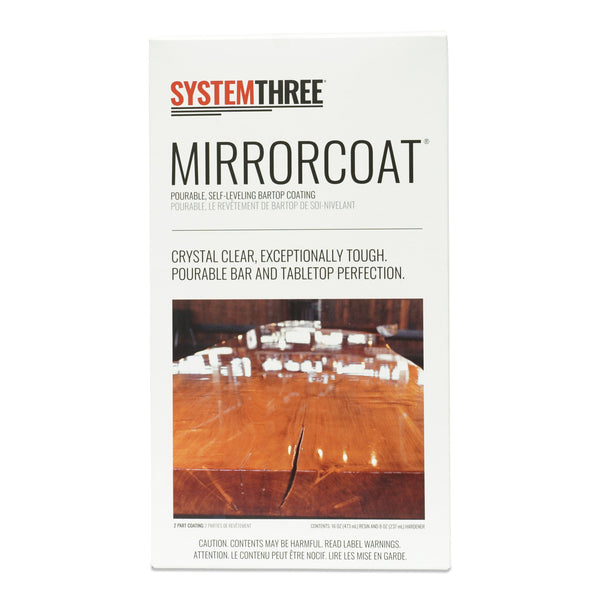

                        The west systems didn't ring a bell, so I called my buddy and got the name of the stuff. It's called Mirror Coat. Here is a link to it
                        MirrorCoat is a pourable, self-leveling bar and tabletop coating.
                          MAS Epoxies
                          I used a lot of MAS epoxy over the summer on a boat on which I barrier-coated the hull. I did a lot of research before choosing which system to use, and the MAS epoxy is very low VOC, so no hasmat shipping charges, no amine blush to deal with between coats, and much cheaper than West System or System Three. their website is www.MASEpoxies.com. They make two consistencies; one is a thin-set resin which soaks well into gelcoat and glass to provide a good base coat for adhesion of subsequent coats (this is probably what you want to use for a bartop), or a thicker resin called FLAG (Filleting, Laminating, and Gluing) that is more suitable for building up thick coats, gluing, and making fillets (smooth joints). Probably worth looking at.
