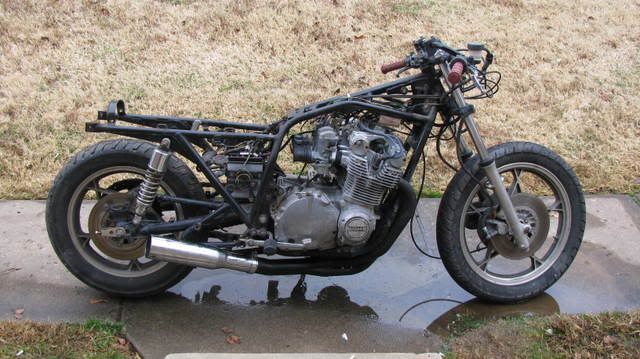

today we are loading the bike up and taking it to my inlaws, where i can work on it. i have alot of parts here and on the way for it. i had the bike running before winter hit, and now im tearing it down to freshen it up.
ive purchased 2 tanks to replace the one that came off of the bike, and im beginning the think my frame is a stupid "L" frame, because neither of them fit over the bars going from downtube to the neck and tie into the hoops, and the rubber discs the tank slides into are too wide.
today i installed my 4-1 drag pipe off of an 83 1100 (yes, 1100 stuff will fit a 1000), and my clubmans with new Oury grips. im currently rebuilding the rear brake caliper and will be replacing the front master cyl with a 03 GSXR piece. after the first of the year, ill be rebuilding my carbs and replacing everything i can. cycleorings had alot of stuff for me, so i got everything i could for this bike. i have a jet kit on the way, and will likely be putting that in during my carb rebuild.
i was giving everything a once over, making a list of things to look into and/or replace due to lack of care and chopping from the PO. im probably going to be rewiring the bike it looks like. im looking into going with a monoshock swingarm, but thats on the back burner.
here is where im at.

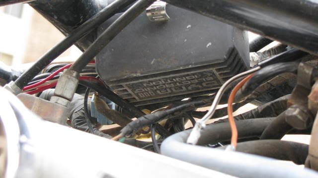

upon further inspection of the wiring harness, looky what i found left by a previous owner:
