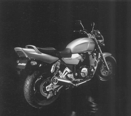

                        Really diggin your project, I am definitly subscribed. Is that Yammi an FZ? I dont recognize it, but it looks absolutly killer
                          Appears to be a Yam XJR1200....not sold in N. America.
                          Tony.
                          '82 GS1100E
                            awesome bike wouldnt ya know it they arent selling it here
                              Actually it's a XJR1300, but it looks pretty much same as the 1200.
